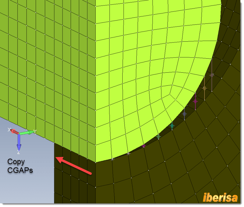

Jul 24, 2020 #1 alan.s Structural Joined Jul 19, 2018 Messages 5 Location CA I am new to MSC Nastran and i am looking to create gap elements around cylinders. Does anyone know how to do it? Thank you in advance!

Aug 21, 2020 #2 BlasMolero Mechanical Joined Aug 12, 2009 Messages 930 Location ES Hello!, In this post I show how to mesh & solve a HERTZ contact problem using CGAP elements with Femap & Simcenter Nastran: https://iberisa.wordpress.com/2018/12/26/contacto-hertz-en-femap-y-nx-nastran-con-elementos-gap/ Best regards, Blas. ~~~~~~~~~~~~~~~~~~~~~~ Blas Molero Hidalgo Ingeniero Industrial Director IBERISA 48004 BILBAO (SPAIN) WEB: http://www.iberisa.comBlog de FEMAP & NX Nastran: http://iberisa.wordpress.com/ Upvote 0 Downvote
