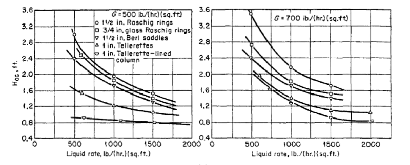

I need your help on absorption HTU. Please refer to attached. It's related to base system HTU from KGa curve. How do I get HTU using formula HTU= G/ Kga?
Below is the test conditions:
Bed height 3.05m
Liquid concentration: 4% NaOH
Conversion to carbonate:25%
Inlet CO2 concentration: 1%
Gas rate: 900 lb/hr ft3 atm, divide by air density 29 lb/lbmol= 31 lbmol/hr ft3 m
Pressure: 1 am
Assumptions:
1) This is chemical absorption so consider gas phrase only.
2) Assume at liquid rate 8 gpm/ft2 using Saddle #1. The Kga value is ~ 3 lbmol/hr ft3 atm
3) Using HTU= G/Kga= 31/3= 10.3 ft!
4) This HTU value is very high and not reasonable.
Thanks for attention and please help !

Thanks for checking. Please see normal range of HTU taken from Chemical Process Equipment. As you can see, the range falls within 3.6 ft -0.8 ft. Same test conditions. So, there is something wrong with my calculation. Could you please help again?

For what absorption service is this Hog taken from? Same as CO2 - dilute NaoH or some other service? CO2 - dilute caustic is a relatively weak chemical reaction so Hog will be much higher than for other services where there is a stronger chemical reaction.
Stronger chemical reaction than this case leads to higher Kga which translates to lower Hog or HTU.
Also these reported values are for overall Kga, so no need to add a correction factor for liquid phase resistance ie Hg or HTU = Gm/Kga.
If you look at table 14-3 in the same chapter in Perry 7th edn, Kga values range from <10 to in excess of 300 in SI units (kgmoles/hr.m3)for the same type of packing. Kga values are NOT a function of the packing type alone, these values are strongly influenced by solute and solvent pair affinity, gas and liquid flows, solute and solvent concentration and system P/T.
These graphs you have posted for "typical HTU" are for the ammonia water system, which I found from Perry 6th edition in the chapter 18 on packed tower hydraulics design. This is a much more reactive system that this 1%CO2 in 4%wt caustic solution, as evidenced by the high Kga value of 340kgmoles/hr.m3.atm as published in Perry ( so roughly 7x higher Kga than for the CO2 - NaOH system). So the same packing in this NH3 - H20 system would maybe give you a HTU of 10/7 = 1.5ft which is what you are mistakenly expecting to get.
So these graphs for Hog you have posted later are the wrong comparison basis, since it is not for the CO2-NaOH system at the same operating conditions as that for the first graph posted.
