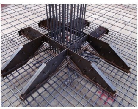

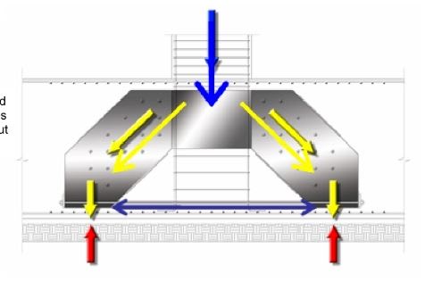

To attempt to put my money where my mouth is, here's one of the big innovations from a NY highrise firm. Apparently, these magical, STM, punching shear preventers have been installed at the base of some Manhattan Skyscrapers. All the FEM'in in the world won't be worth squat when the columns just slide through the hole in the middle. What do I know though? I'm just some internet nutball lacking a back stage pass to Club Skyscraper

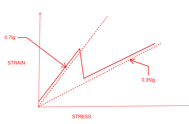

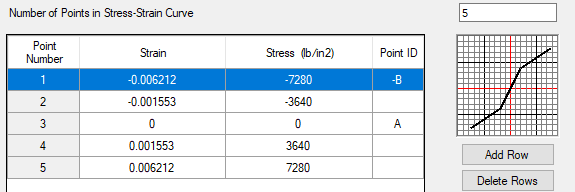

In order to get the juices flowing here... I'll take the first stab of how I would do it in ETABs/SAP.
Set nonlinear material stress-strain plot that is somewhat binary in nature. Up to a certain stress level you have a certain E (representing the 0.7Ig region) after that, cut your stress-strain slope in half (representing 0.35Ig region). Images shown below, i have not done the research on what these values are, just shown for example
After that, setup a layered shell in ETABs with non-linear nature in the S11 and S22 direction.
Note, I have no idea if this is the correct way to handle this, but those are my thoughts. I can run some test models for the group and post results if interested.
I am sure Josh might have some good pointers for us as he works for the company.
S&T
Stress strain curve for the concrete? I need time to digest, thanks anyway :)
Actually now that I thought about it a little more, maybe the stress strain curve would look something more like this
(sorry i flipped stress and strain on the diagram, you should get the picture though)
S&T
