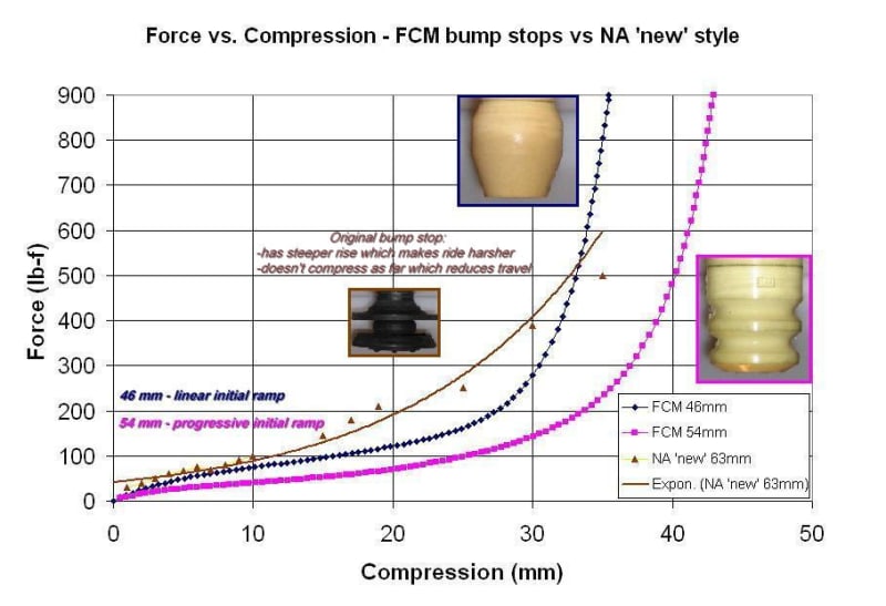

Using ride aids/ jounce bumpers or whatever is not quite as easy as you'd like it to be. The rates are typically very non linear as the bumper engages, and they tend to have a lot of hysteresis
This type of foam ones in particular are robust, but tuning them is a black art. note the compression rings in some of them

Bump stops do seem to have an initial near-linear response before an exponential increase. If you're referring to damping them, clearly they cannot easily be damped without some sort of position-sensitive active damper. Or perhaps that's not true: with a digressive damper, the foam bumpstop would decelerate the piston velocity, eventually enough to return the damper to the high-force damping region.
Further, there is a class of (junior formula?) racing that utilizes rubber pucks for both spring and damper duty. Are foam bumpstops likewise self-damping?
