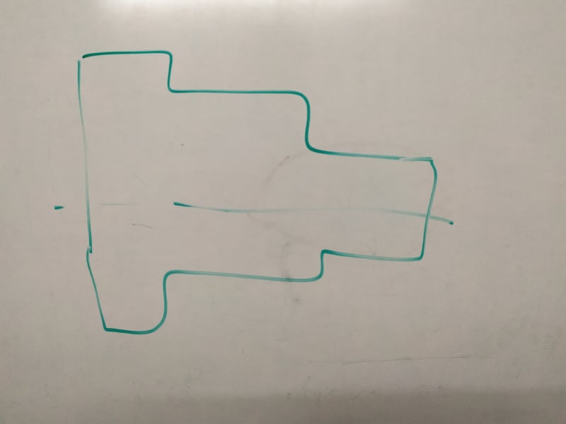

Some of the dimensions in 2D drawing are not visible (not hide / show).
It happens when features are edited after the 2D drawing is prepared / working on copied drawing.
When trying to select visible dimensions, if these hidden dimensions are present near by visible dimensions, these hidden dimensions only selected and blue colour dot appear at extension line starting point, dimension line arrow point.
How to solve this?

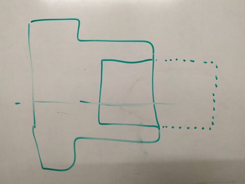

I didn't changed extrude to revolve.
In revolve feature, consider three stepped diameter.
After revolve command,
Edit sketch
Change one edge as internal feature and other two remains stepped diameter.

Sa-Ro,
If you share the actual SolidWorks part instead of just a PDF, someone maybe able to figure out a resolution
Original sketch
Modified
Aha!!! How many times have I re-learned this lesson?
As you create features and then more features, and then drawings, the references begin to accumulate. A dimension on a drawing is "tied" to an element on the drawing (a particular edge or point). That element is in turn tied to a particular feature on the part. That feature on the part is tied to a particular line in a sketch. As long as that line in that sketch remains, that dimension in the drawing has something to relate to. If however, you delete that line or somehow change its relationship to the part feature, that dimension no longer has a reference. It will show in the drawing as a "hanging" dimension, or will disappear entirely. This applies even if you replace the original line with another one exactly like it. That dimension only referenced that original line in the sketch, not a new one no matter how similar it might be to the original. In your example above, if you made those changes without deleting or adding any lines or points, then your dimension will remain. If however you made that change by just manipulating existing lines and points, then the dimension will remain. Moving lines and points retains their reference dimensions. Deleting lines and points destroys them. Is that your problem?
