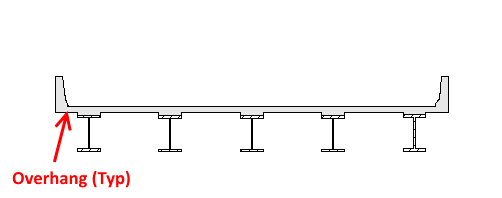

I am attempting to compare excavator loading on a bridge with rated loads. My typical approach is to compare load effects of design load with proposed equipment. In this case, contractor is trying to maximize equipment size and I'm looking to bridge rating to sharpen my pencil. The bridge is being demolished, it will never be opened to public use again.
The design live load is H-15, built in 1930's. Load Factor method is noted. See attached photo for rating report excerpt.
Is the following the correct way to compare moments using the Rating Factor:
H-15 Moment x 1.32 Rating Factor >= Excavator Moment
I am using Lever Rule to determine distribution factors to girders and all comparisons are on a girder basis.
Thanks for any feedback.

No, if they're sawcutting bridge overhangs, you're talking about a concrete deck bridge, either on A7 steel girders or concrete girders. Some of those steel girder bridges had "quasi-composite" details thrown in near the deck. I was never sure how effective they were, but you'll want to be careful about that if you are getting too close to the girder lines with your sawcuts. And if you have concrete girders, make sure that your sawcutting plan doesn't allow the pieces to deflect and bind against each other during the cut, or you'll definitely overrun your closure window!
Yes, working from a recent bridge rating to build a capacity envelope is a valid approach for capacity. I have analyzed this exact situation for several bridge demo jobs. Of course, you want to allow a healthy safety factor if the inspection reports aren't recent (I'd be fine with 2-3 years) or leave any ambiguity about the condition of the bridge, areas that are hard to inspect, etc. But it's a good first pass, and for some jobs it's enough to save a lot of more tedious modeling and analysis from scratch.
Figuring out the excavator demand (picking) is a different animal, as CANPRO alludes. Picking over the side you can easily get to 80/20 or 90/10 splits between the tracks if the picks are large enough relative to the excavator (or you're at max reach). If you pick/swing over a corner, you can get to triangular track loading with 30-50% of the track lifted off. So make sure you're understanding (or restricting and enforcing) how the contractor wants to use the excavator.

Only the overhangs will be demolished with excavator up top.
It is a fracture critical structure...
"Fracture critical" implies that the superstructure has simply supported steel stringers instead of concrete deck girders.
If the remainder of the superstructure (everything except the overhang) will be worked with a crane from below, seems prudent to use the crane for the overhang, also. Avoid the maxed-out excavator problem completely.

Some pics.
I'm looking for some pretty narrow feedback on correct use of load rating factor. I recognize we don't know each other, so there is no context for this request for help.
Yes understood on operating restrictions and track pressures. I typically take 100% of excavator over single track. I've observed lots of bridge demolition and the excavators are definitely dancing around....most operators are cowboys. You have to be to operate heavy equipment on 100 yr. old structures. Most operators that have been around have a story or two.
Crane cannot be used for overhang for sequencing reasons. There are limited RR closure windows to work in.
 https://files.engineering.com/getfile.aspx?folder=cf2fe8e2-9547-4181-974c-4e06b7b5db51&file=pic01.pdf
Ah, yes, good catch SRE... I initially thought steel girder, hedged my bets, and then forgot about it being fracture critical!
Cranes are less desirable for sequencing, not to mention that sawcutting and cranes make for very slow work. Sometimes you need to do it that way, but being able to cut/break most of the way through and then pull on a chunk of deck at your feet with the excavator is much more efficient.
Seeing those asbuilts -- I'll definitely vouch for your method. That's a great fit for a bridge like this.

My biggest question is: do you review the calculations of the engineer that determined the stated capacity of the bridge as part of this process? If not, who is responsible for any failures during the demolition as a result of errors in the original analysis?
Hypothetical scenario - the engineer who determined the capacity/load rating factor of the bridge made an error in their calculations and overestimates the capacity of the bridge by say 10%. The engineer responsible for the demo process relies on the capacity/load rating factor to determine the demo loads are acceptable, but pushing the limits of the structure. A structural failure occurs during demolition. Assuming the 2nd engineer made no mistakes in their analysis, who is responsible for the failure?
Ultimately, the demolition engineer usually owns that scenario. Same as if there were an error in the demo engineer's own calcs, or if both sets of calcs were perfect, but something about the bridge condition was missed during inspection.
The repercussions will vary depending on the demo engineer's contractual relationship to the contractor, and the contractor's contract with the bridge owner. Many bridge owners will CYA by providing the inspection reports for information only, in which case the contractor needs to price in risk (and do their own inspection). Some inspection reports can be held to a more factual standard of evidence as the benchmark for existing condition. Whether the contractor or engineer carries that risk varies.
That said, not a legal expert, but I believe basing design on a state-approved, recent bridge inspection report (that was not provided "for information only") at least meets the "standard practice of care".
There is risk. I've been bitten by that specific risk, on a much more complex bridge demo. But not that much more than any job with existing structures.
