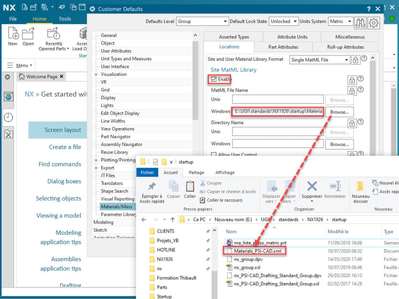

We want to connect the NX to a material library that is stored in Site standard folder. This folder is looked into when NX is launched . is there any Env variable I need to set in env.dat file?
From earlier NX versions, there is a setting in the Customer defaults.

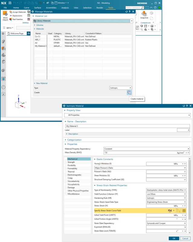

I see we can pull the material database from the site folder . But now, If I want to add a new material to it, When I go to manage material >> create new >> it goes into local copy and not site level. How can I make it go and update at the site level? Only way currently we are doing is editing xml file..

Here is the process with simple screenshots in NX1926, but it's the same in previous !NX version
1°) I Assume that you succeed to set your xml fil at the group level

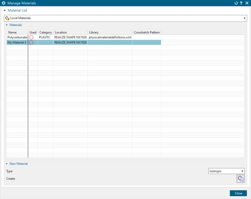

2°) Then you know how to create a new material
3°) the result is in local materials by default

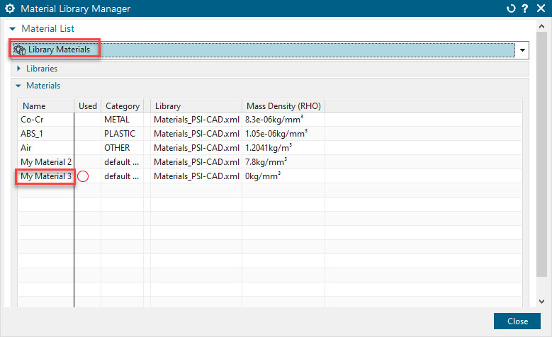

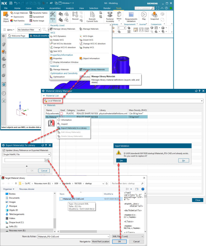

4°) Now you can export the material to the library
5°) And the result is in the library materials [dazed]
I hope it's clear and this help
