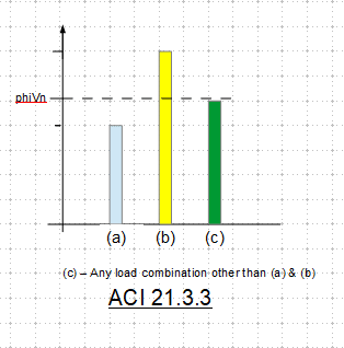

I just want to clarify the concept of ACI 21.3.3 . I copied and pasted the same picture below ,
Ø Vn shall not be less than the smaller of (a) and (b)
Requirement (a) ; Ø Vn ≥ ( ((Mnl + Mnr )/ ln ) +,- wu*ln/2 ) where wu= 1.2D + 1.0L + 0.2S , Mnl and Mnr are nominal flexural strength. Mnr and Mnl are calculated with fs= 1.25 fy and Ø = 1.0
OR,
Requirement (b) ; Design load combination with 2*E U=1.2D + 1.0L + 0.2S + 2.0E
Calculate Vul and Vur for this combination, Ø Vn ≥ Vu
I think the commentary R 21.3 is clear....pls read again..

Stay on 318-08, the code is clear on selection (a) or (b) to be the minimum (greater than the smaller of the two), but I suspect the hidden intention is setting the maximum as graphically shown below.
318-14 has only changed condition (a) from the least gravity load combination to any gravity load combination plus the shear from lateral load effect. The hidden message stays - ØVn < Shear from any load combination + 2E (the ceiling of shear capacity for any members involving seismic effect).
