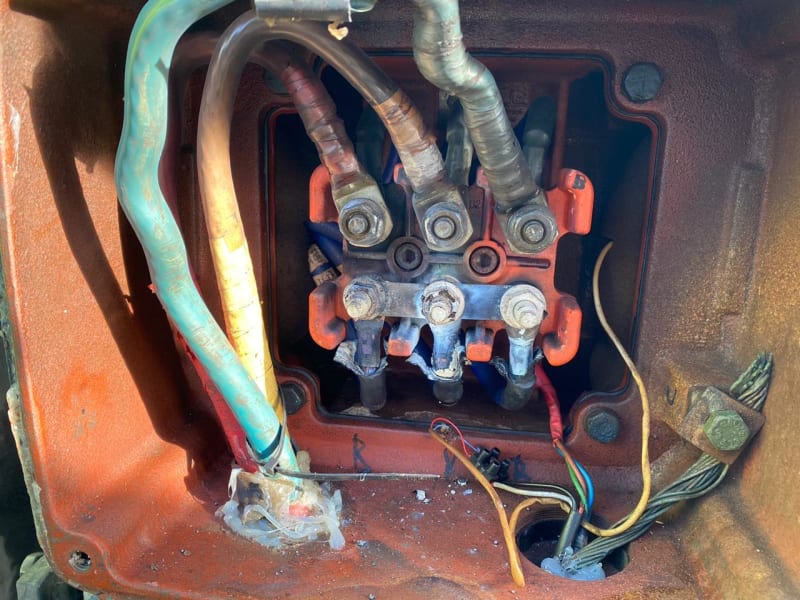

We have several motors 350 kW 379 A 690 Vac star connection with 95 mm2 cable leads that the winding has burnt or supply cable & motor leads burnt in the motor connection box. Thks
We just had a problem on a 132 kW 690 Vac motor. The star point cables & lugs have heated up. Since we will not change the supply voltage or starting method of our motors, is it possible when we rewind a burnt motor, to do the star point inside the motor on the winding coils? This will avoid more lugs, connections which may have loose connections and heat up.

Since the motor winding is good, we have cut the cables of the star point, put new lugs and linked the 3 cables as our plant must operate. To replace the motor, we need a crane. This would take time and we might need to stop or reduce our plant power generated. We might be in penalty also.

A1. I look at the image and would like to submit my observations for your consideration:
a) All three Incoming conductors are over-heated at the terminal connection. The heat is conducted by the conductor which Over-heated the insulation. The insulation is NOT over-heated after approx 150mm? away from the terminal.
b) All three star-point conductors are over-heated at the terminal connection. The heat is conducted by the conductor which Over-heated the insulation. The insulation is NOT over-heated after approx 50mm? away from the terminal.
c) If the incoming or the star-point conductors are under-sized; the heat would be generated along the whole length not within a short length from the heat source; as evident from the image.
A2. It does not matter whether to connect the star-point conductors inside the winding or on the terminal. All IEC LV motors are wired with 6 wires terminated on the 6 terminals. No problem. It may be advisable to maintain the 6-wires terminated on the 6 terminals, in case there is a possibility of using star-delta starting method in the future.
A3. My conclusion is loose connection which result to high contact resistance at all the 6 terminals.
A4. You should request from the motor manufacturer for their recommended tightening torque for their terminals. Following are as "guide", the tightening torque for "dry" steel nuts may be say M10 grade 8 nut 48Nm, M12 grade 8 nut 80Nm; in case the advice from the manufacturer is not arriving in time.
Caution: These suggested "guide" values are for "dry" bolt and nuts. DO NOT/Refrain from lubricating or oiling the terminals or the nuts. Over-tightening would result or a much lower tightening torque value shall be used.
