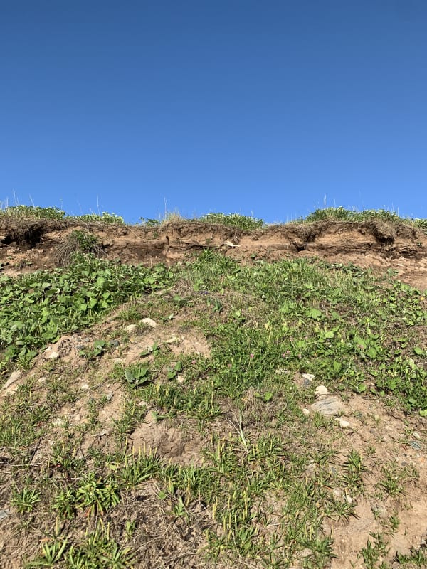

Hi, I’m looking for advice on how to stop this erosion on a small beach front property I purchased. I did some research online and there’s a couple techniques to solve this. I was thinking of using matting or chain link fence spiked into the side of the hill and using field grass sods native to the area spiked into that. Would I have to sod the entire side of the embankment (15’) or just 6-8’ down.
My other option I was looking at was stepping the embankment, 2 8’ sections and then sodding it.
Appreciate any advice you may have.

The oceanwater isn’t the primary reason, I think it’s more from exposure to extreme wind (150+kmh) and rain and perhaps frost breaking every spring. The property is in the wreckhouse area of Newfoundland. I walked the beach front and other areas of embankments have naturally fallen off and grass/weeds have taken root and stopped the erosion. That’s where I’m on the fence, to mimic what nature has done or create something.
Here’s a photo.
All that exposed cobbles and a gentle "beach" is a signal of past high wave action. I'd hear from any "locals" familiar with the shore conditions over time and my bet is there can be major wave action. That meager vegetation can regrow rapidly.
Depending where you're located, federal, state/province, or local governments can have restrictions on what you can and cannot put in for erosion protection. I would recommend getting a waterfront engineer involved or, if your local regulators are friendly, you could ask them about any limitations and if they have any recommendations. You could also take a hike up and down the coastline and see what other's have installed and if its still good condition.
