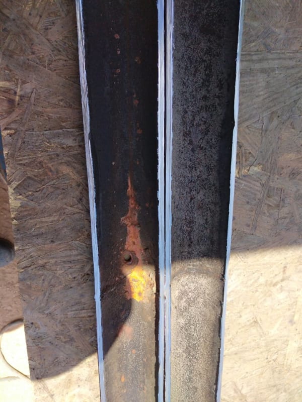

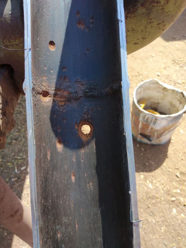

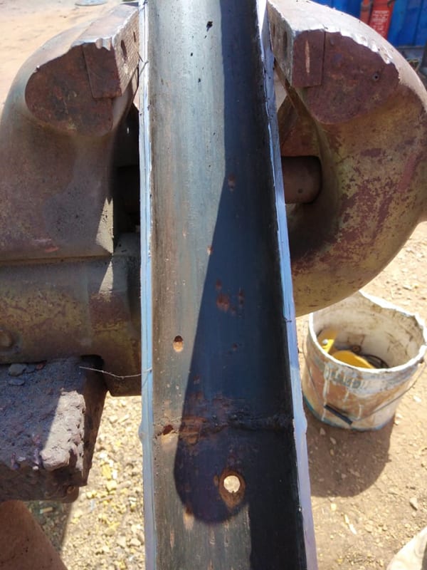

Hello guys
We opened transversely the concerned pipe and besides to the leak shapes (see photos bellow), we noticed the presence of chlore, salt and sulfur impurties.(More laboratory tests will be performed)
Api570 and API574 inspectors are working now on the possible reasons of such corrosion shapeS and the most propable thing was Mic or material nuance incompatibility with similar service conditions.
Your interpretations.
Alaa Edine SMAALI
Energy (Oil&Gas) Project Engineer
Since it is all in the bottom I lean toward either deposits (mud and such) settling out or the effects of untreated hydro water sitting in there. When piping is drained there will be a small amount of water sitting in the bottom of the pipe. As it evaporates all of the impurities will be concentrated. And while it is sitting there any microbes present have a chance to start growing.
What is your flow velocity in this?
What did it look like before it got cleaned off?
It would be worth it to take a cross-section through some of the pits early in their lives so you can see whether the pitting is hemispherical (like oxygen pitting) or if instead the attack looks like internal attack as is often associated with sulfate reducing bacteria (SRB) under MIC attack. Regarding MIC: the ID surface does not have the slimy and dark discoloration often associated with microbiological attack.

It appears that weld spatter that dropped to the bottom inside of the pipe may have been involved, as well. Maybe flux.
Correction, make that full hyperspeculation mode.
The facts that the pits are only seen very close to a weld, get bigger and more frequent closer to the weld, and appear only in the bottom section of the pipe, do not suggest any ideas to you IM? Like many of your posts, this last one was not very helpful to anyone. I hope you display more positive behavior at work.
