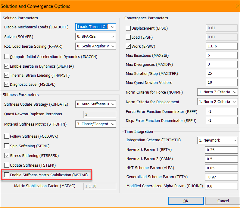

Hello,
I just know that assigning a very small value to the MSTAB parameter (for example: 1e-12) helps in convergence of non-linear problems.
Does this parameter help the solver in effectively handling the zero-energy modes or is it doing something else?
Regards,
Su
Dear Su,
MSTAB is matrix stabilization parameter for the Multi-Step Structural NonLinear (SOL401) solver of Simcenter Nastran to allow a solution to proceed when an unconstrained condition exists.
For example, if you are relying on contact conditions to prevent a mechanism, but they may not be well established at the start of a solution. This matrix stabilization option is available by setting the parameter MSTAB to 1 on the NLCNTL bulk entry.
The MSFAC parameter, also on the NLCNTL bulk entry, is available to define a scale factor for matrix stabilization. Specifically, when you define MSTAB=1, the software scales the diagonal terms by the factor (1+MSFAC).
