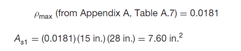

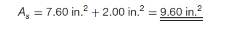

I read this tutorial before, you just hit where I am getting confused:
But As in tension is:
So, for double reinforcement, we should have 𝛒 > 𝛒 max cause we have: As = As1 + As2 && As1 = 𝛒 max x b x d.

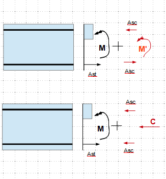

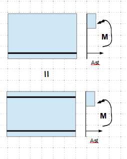

The graph below might help you to get better pictures on the effect of compression steel.
You might ask what is the effect of compression steel in a typical design/detail, which provides but ignores the compression steel. The answer is "no effect", as tension steel will yield prior to any effect from the compression steel. However, the beam might not have failed as the tension steel can continue to elongate (with the increase in deflection) until reaching ultimate state. Therefore in normal design, the compression steel can be considered an insurance.
