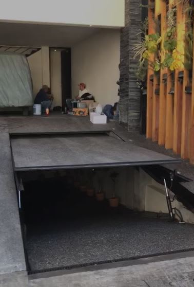

I have 2 hydraulic cylinders that work in parallel to lift a steel ramp. We are replacing some old hoses that are damaged and are hard to reach. The current hoses have a tee that divides the flow right at the middle and then two hoses that have the same length go to each cylinder. But the possition where the tee is right now is probably the cause of why it got damaged. We are planning on replaciong the hoses with a short one (0.5m) and a long one (4.5 m) that will go to each piston to reposition the tee. Some quick calculations give me that the cylinder with the longer hose would have a 16 psi greater pressure loss compared to the other cylinder. Will this affect the system or is the pressure difference negligible and will work fine?

Heres a picture of the ramp. Im not really sure if it would deflect the load or balance out. What do you think?
I think any out of balance forces or one piston extending a little bit more than the other will twist the ramp. Now whether that would be self correcting is difficult to see but I don't think so. If that deflection causes one side to jam the other will just keep going and twist it some more.
Not easy to see what the weight of the ramp is or how long the arms are when extended.
The original design worked with equal length hoses. Why risk it for the sake of another 4 m of hose??
Like I said - if you can't measure the pressure then you really don't know what percent increase is. Might be OK, might not be.
Nice double deck garage though! Is there a bit of the ramp missing?
Thanks for all the help! I really appreciate it. The ramp is actually lifted to the point its completely horizontal, then a second actuator (a garage door opener) slides the ramp inwards. Thats why it looks shorter.
Then you really really don't want one side to be even a little bit higher than the other.

We found there were aditional issues with the system. The plastic tank of the hydraulic unit was broken and was the place where oil was leaking. We believed the leak was in the hoses that we were unable to reach/inspect. We will replace the tank first, then test. If the problem persists we will then consider replacing the hoses after doing some aditional testing. The cylinder do in fact go full stroke, sorry if i forgot to mention that. The ramp in fact is the only thing that will be lifted.

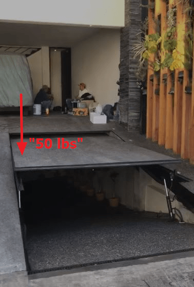

Here is a test you can do with the current 50/50 hoses.
If we assume the piston area is 4 square inches you can simulate the 16-4 = 12 psi pressure difference by adding "50 lbs" (equal to approx 6 usg/22 L of water) of mass above one of the cylinders to create more load pressure on one side.

Hey guys, just bringing you an update. We ended up not having to change the hoses. After we replaced the tank and fill it with hydraulic oil, we tested and the right cylinder was not extending. It turns out the cylinder chamber that isnt being used had a leak in the o-ring/seals. Additionally both of the cylinders had plugs in the unused chambers. Since the cylinder that was leaking got filled with oil in the unused chamber, it couldnt extend while the other cylinder compressed the air in its chamber. We proceeded to remove the plugs and that allowed the system to work again. Even so, we proceeded to remove both cyllinders and replace all o-rings/seals to stop present/future leaks. The system is now working perfectly with a new metal tank, new oil, and repaired cylinders. The hoses didnt need to be changed.
