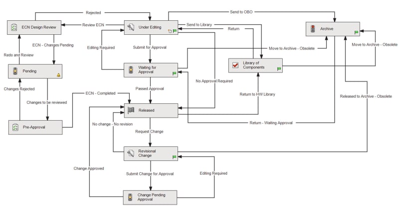

We have SW PDM Std and here is our workflow for all files in the vault. It can be PDF, Excel, JPG, not just SW files:
