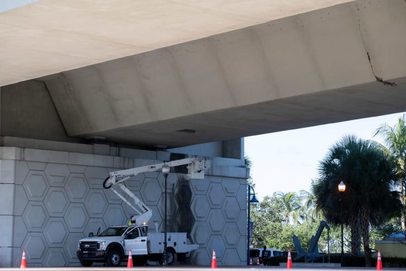

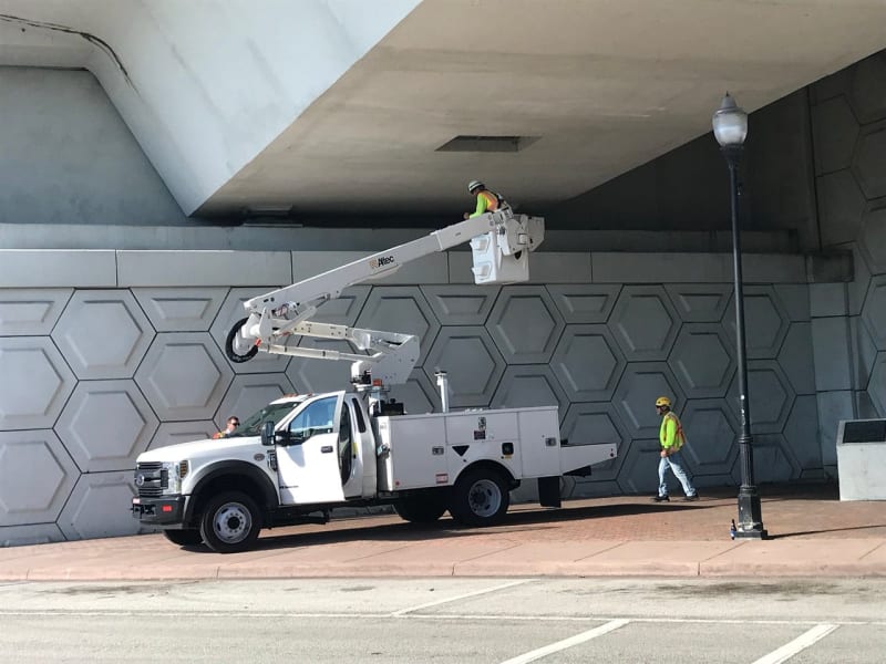

Imminent collapse looks a bit strong, but for sure, its splitting along what looks like a construction seam. Was this a post tensioned beam structure?
Precast hollow box sections apprently
Can't see how the segments were connected, but there is a hollow road inside apparently with two golf buggies to drive up and down!
Yes, it's a segmental box bridge, post tensioned, the segments were match casted and connected using grout and post tensioning. Looks like some of the bottom cables have corroded, and the span is ready to go..
The entire cross section shall be always in compression, so any crack appearing calls for emergency shoring and closing of the bridge.

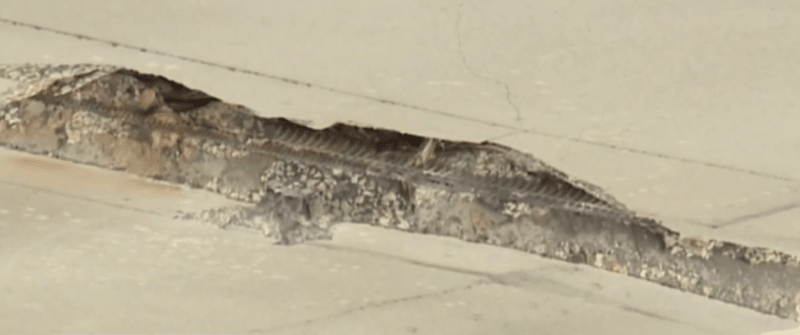

Cracking, spalling or both?

The locations suggest it isn't just a superficial.
I grew up in Stuart, home to I believe 4 segmental box girder bridges, and this is causing a traffic nightmare for my family.
Nothing seems obvious from the crack pattern. Could simply be spalling. It’s in the right spot to be a flexural crack, but as Wiktor said above, the whole thing should be in compression. But I’m not a bridge guy, and these segmental box girder bridges are a real specialty. I found some good general info here:

The locations of the cracks at the segments' joints may indicate corrosion of the "stiff" reinforcement located too close to the segment edge, causing the spalling.

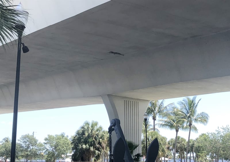

The photographs posted are not of the highest quality, so is difficult to asses the exact nature of the cracking, and distinguish in between spalling (local corrosion) or major problem.
But if the cracks were through and also present at the inside of the box, the entire bridge should be closed and carefully inspected.

Given the stain patterns along the span, my first guess would be spalling due to rebar corrosion.
If left unattended I would expect some of the other stain marks to develop similar spalls within a few years.
If this is spalling the crack may terminate at the rebar.

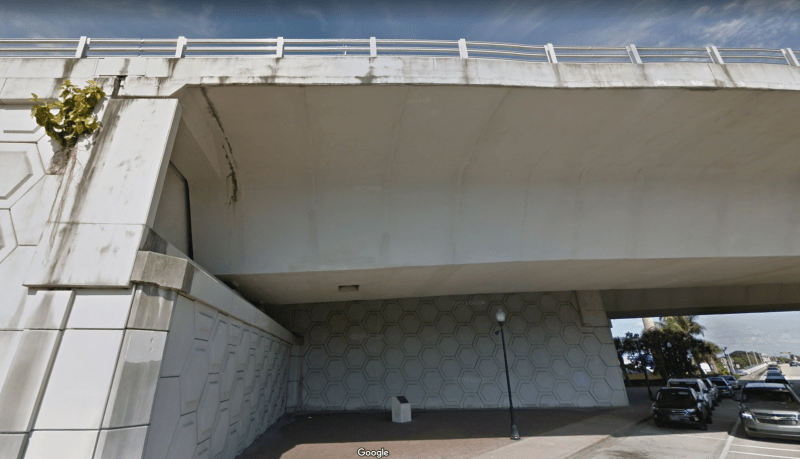

Imminent collapse does seem a little over blown. But I'll go with flexture cracking more than corrosion spalling. There are 3 different large cracks in this section two in zones of tension, one in a zone of high shear.
And at least one of the cracks isn't new. This is 13 months ago from google maps.

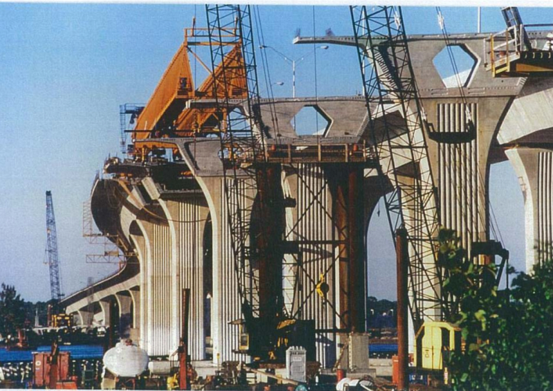

I've found several photos online which I believe are of this bridge. (they aren't always labelled) It would seem that the space for bottom tendons is minimal so this bridge is largely a cantilever design. Though the end being discussed looks to be simple supported.
**Disclaimer. Again I'm a rookie in this field so please take my comments with a healthy bit of skepticism.
I had a better photograph elsewhere but I can't find it now. There was very few ducts for bottom tendons.

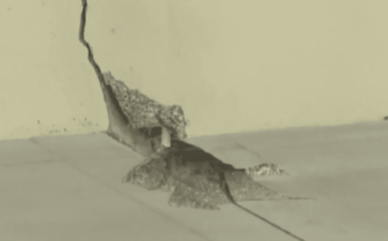

That's an interesting picture. Looks like the sections on the piers are hollow inside to presumably anchor / tension the tendons on both sides. Still looks fairly alarming vertical crack indicating loss of tension.

If it is the closure section between two spans then maybe it is the bottom continuity tendons which are problematic / corroding.
Only if they've found issues with the top tendons would the bridge be in serious danger.

Any cracked tendon is a serious risk, and the excellent photograph you have posted clearly shows that one (or more) of the bottom (so called continuity) tendons has snapped, as the crack is wider at the bottom, indicating total loss of post tensioning in this area. As the transmission of the shear forces in between the segments relays on the "forced friction" and protrusions matching recesses in the adjoining element, it's a rather big problem. Also, having intact top tendons, and corroded bottom ones, is adding to the positive (LL) moments in the span.
Anyway, any transverse or vertical crack in post-tensioned structure is indication of a very serious problem, and any competent engineer would close such bridge immediately.
I just meant that the bridge wouldn't collapse completely if the top tendons were good but for sure it looks serious.
