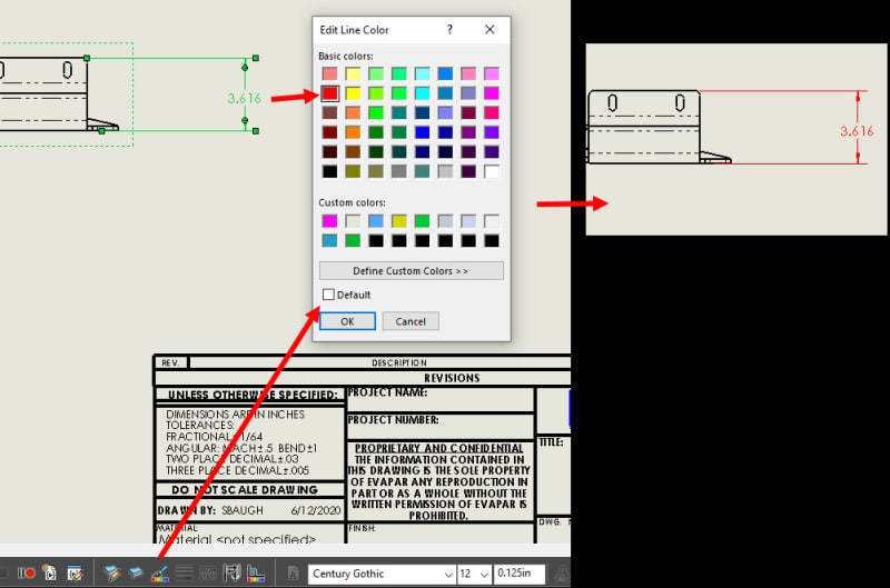

If you want to set dimensions in a drawing to a different color. you need to either use a Layer or use the "line color" feature in the line format toolbar. I use the line color because for critical dimensions I make them red otherwise, they are always black.

You can setup templates with a dimension layer as a certain color. You can also save these settings in Document Properties, Drafting Standard, Save to External File. The, in a current dwg, Load From External File.
A macro could be written for this (someone may already have one).
