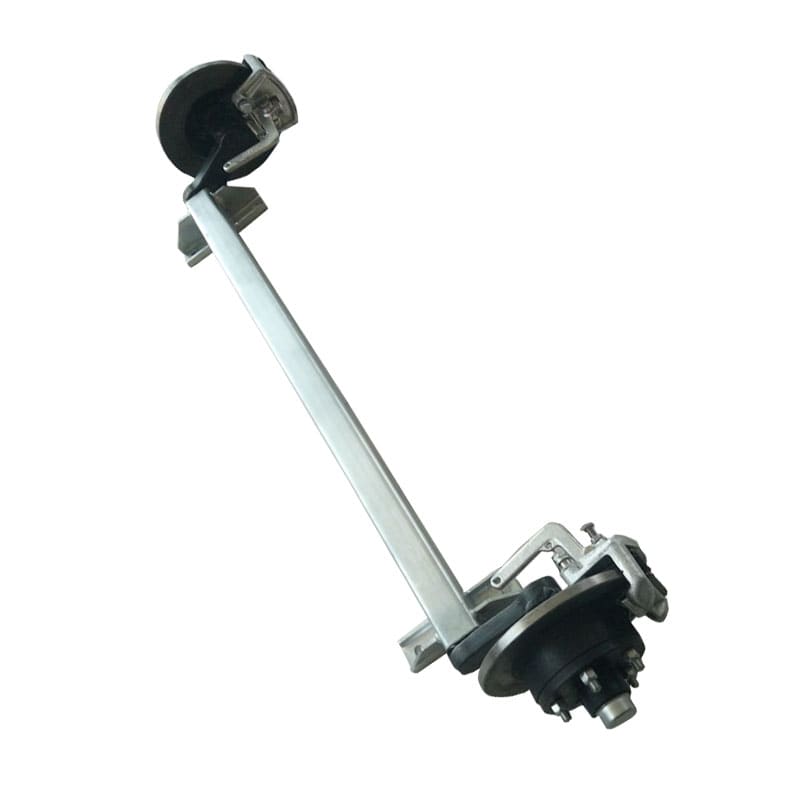

Is straight axle better or torsion axle better for a boat trailer?
Haway
Automotive
Jun 12, 2020
1
CN
Are the boat trailers with straight axles better or that with torsion axles better?
Link
Better at what?
I think straight ones ore cheaper.
je suis charlie
It seems the torsion axle hides the spring so you can't see when it's corroded and about to fail.
The torsion axle requires less space; it doesn't need clearance around it for the axle to bounce around. Allows the trailer floor to be lower to the ground.
If that's not an important factor, straight axle with leaf springs is cheaper.
Almost all trailer suspensions are waaaaayyyy too stiff.
Torsion axle likely has better damping (rubber insert). May have dynamic toe problems. Not likely to have brakes.
Torsion axle has fixed spring rate, you get what they stuffed in there plus tire deflection. Same with ride height. Over-slung or under-slung. Buy a new, heavier motor, and you need a new trailer.
Solid axle with leaf springs can be altered easily by adding or removing leaves. Break one on the highway and you will need a tow truck. Break a spindle on the highway with a solid and you buy just a new axle or insert, then change it out.
Torsion axle less likely to drag home seaweed, fishing line(s) and the other crap that hangs around boat launches. Just don't back up into something that will block the wheel. Something will get ripped off (been there).
You can air bag torsion axles to be progressive, and adjustable. They do have models with brakes.
Personally I'd go torsion on a nice small trailer, but I will never have a big truck or SUV to tow with, in which case I wouldn't care so mucht.
If I did it myself I'd get those bag springs that are designed to fit around a shock shaft. That way you could put it around the rubber spring for redundancy.
If you had a dual axle you'd have some redundancy
Imagine unloading a trailer with air bags. Just let all the air pressure out and you're inches closer to the ground.
I can't say I'd use it for a boat trailer. I'm already crazzy about boat trailers anyways. People get those axles under water when they're hot off the highway and never think to lube their bearings. And they don't even rinse it off with the hose when they're done. A used boat trailer is like a ticking time bomb unless you go over all the neglected parts. You don't want to get stuck on the side of the highway with a seized bearing.
That being said straight axle trailers have the advantage that if you do have a problem almost any trailer shop will be able to get you up and going again if they have a big enough collection of parts. And more cheaply too than a torsion axle.

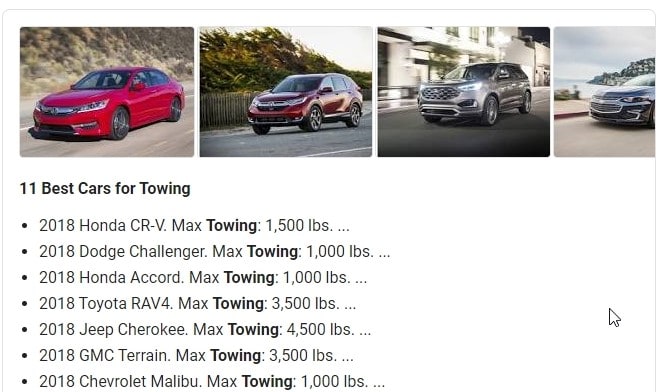

If you can find cars and (not trucks) that don't say this in the manual:
"Toyota does not recommend towing a trailer with your vehicle.
Toyota also does not recommend the installation of a tow hitch
or the use of a tow hitch carrier for a wheelchair, scooter, bicycle, etc. Your vehicle is not designed for trailer towing or for the
use of tow hitch mounted carriers"2019 camry manual
You can find a plethora of cars and small crossovers which have a tow rating of half their weight or lower.
Almost all of the cars on that list have a tow rating of LESS than half of their weight. Look up the curb weight of a malibu for example.

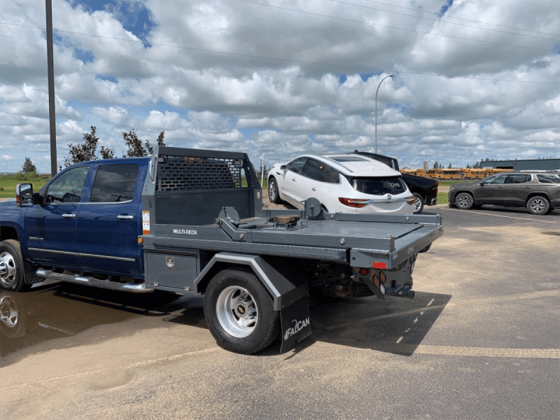

Here the limit is 1000 lbs without trailer brakes.
With trailer brakes?
Engine: 6.6L V-8 turbo diesel
Horsepower: 445 @ 2,800 rpm
Torque: 910 lb-ft @ 1,600 rpm
Transmission: 6-speed auto
Tow Rating: 20,000 lbs. conventional/
22,700 lbs. fifth-wheel
(The 2020 model will tow 35000 lbs.)
