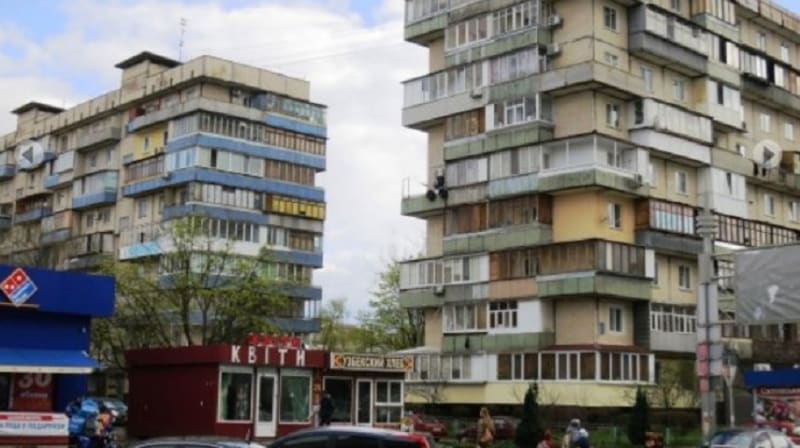

While Russia has building codes, there is very lax enforcement and crazy things go on. The simplest building code item is stair treads. Here, the building code requires to have uniform step heights to prevent tripping. In Russia, one would commonly find uneven steps.
When the Soviet Union collapsed, the occupants of the apartment buildings were given the apartments. For new apartments, the way it works in Russia, the apartment is bare concrete. Then you furnish the apartment with plumbing etc.
On the exterior of the apartment, the owner is allowed to construct any type of enclosure on the exterior. That makes the buildings look haphazard. Very strange.
The workmanship in Russian is also typically substandard. The manufacturing base is very small and most equipment and piping is imported.

Those apartments blocks look like they never heard of owner's association's architectural restrictions. I notice that one building is somewhat color coordinated in blue...ish, the other green. At least they are free to do their own thing. Looks like they're going for greenhouse effect.
