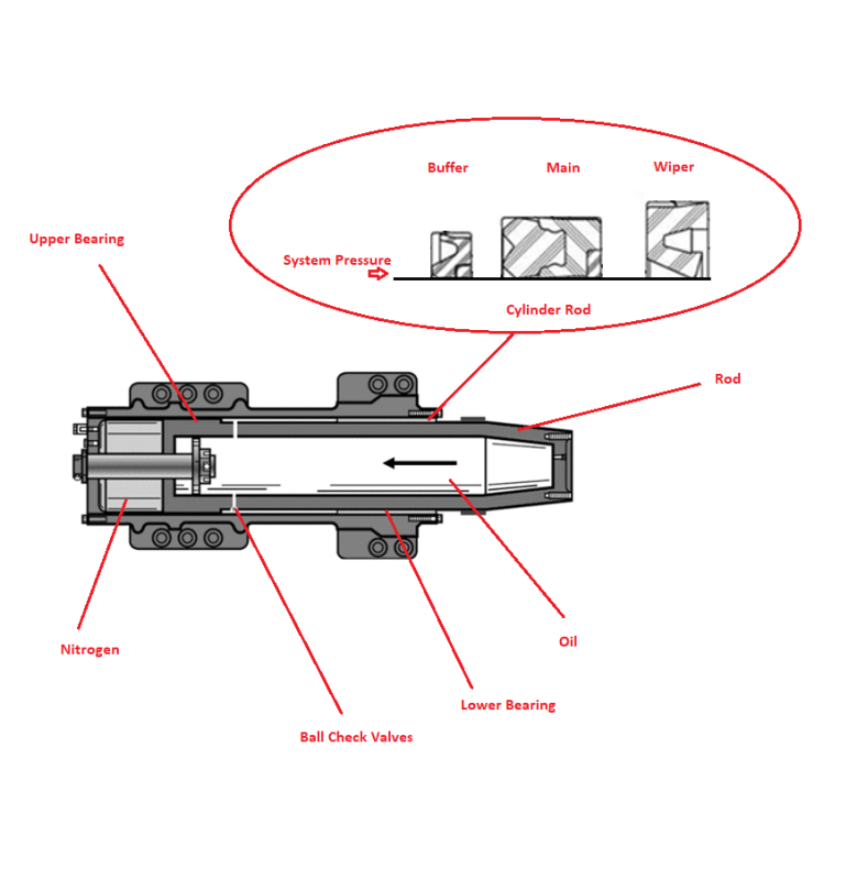

I have a suspension cylinder (from a mining truck) that has a buffer seal, main seal and wiper seal. See below image (in real life this is orientated vertically). The cylinder will be subjected to pressure spikes due to the load the truck carries, ground roughness, cornering etc.
I have observed:
(1) No damage to the buffer seal, I have cut the seal to observe the cross section and there is no damage or deformation;
(2) Main seal has no damage; and
(3) Wiper seal has blow out from the groove
The key aspect to the observation is no damage to the buffer or main seal, but the cylinder is leaking.
I have the following questions:
(1) To blow out the wiper seal, this will require high pressure fluid? If so then does this mean that the buffer seal has become ineffective?
(2) In the event of a pressure spike, how can the fluid bypass the buffer seal without damaging it?
(3) Is the blow out due to low pressure oil that gets past the buffer seal and creates a pressure trap that eventually passes the main seal and then blows out the wiper?

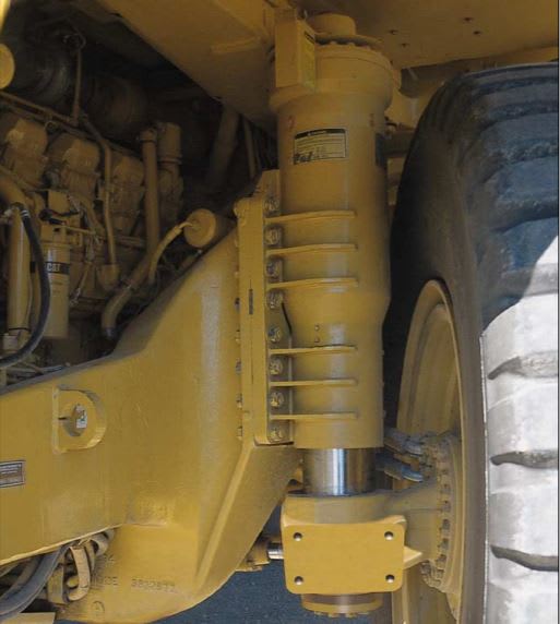

The rod usually has some pitting on it that will require it to be re-chromed. The rod is orientated like the below image.

In the photo it is not a standard cylinder.
What is certain is that a scraper seal lets the oil flow inwardly and outward with less than 1 bar. So the thrust on the joint section remains ridiculous.
On this application there are strong radial loads: How is this load taken up, bronze ring, PTFE carrier. Too much radial play leads to leaks.
There is no oil exchange, so there are certainly significant temperature increases, such as in car shock absorbers when riding on a wavy surface. In addition all particles by gravity go into the joints.

Buffer will provide passage for nitrogen and oil under upper pressure towards the the main seal. When the cylinder expanded with the release of the load or partial load it will cause vacuum in the same cavity of the trapped nitrogen and oil. Partial nitrogen will move back but oil will stay, in the long term the oil will accumulate in between buffer and main seals. Sometimes the vacuum will be causing pitting similar to pump inlets.
For wiper; it is difficult to say something without seeing the drawing. As it was said, it does not hold the pressure. Either ther must be something wrong in the keeper design or the installation is not in accordance with the manufacturer’s procedure. Hard to say something.

Below is a better picture, although simplified.
"So essentially how can I get a leak past the buffer and main seal without causing any damage? Does this mean the seals generally provide insufficient sealing (i.e. there is minimal overlap between the seal and the rod)?"
In the picture of the suspension, there appears to be a rippled, circular texture on the rod finish. A spiral lay in the surface may result from creating a finish with a travel feed grind method. The spiral lay will prevent sealing and allow fluid to follow the spiral passed the seal. A better method would be a plunge grind resulting in a parallel circular lay in the finish. Imagine trying to seal against screw threads.
Ted
It seems that the cylinder, from the suspension photograph, is under an axial force as well as the bending moment. The Bending moment is taken by the radial forces on the sleeve bearings. The friction under this radial force will cause wear on the bearing materials. So this will end up with leaks. In case a large bending moment under large axial force with sudden motion may cause large wear on the sleeve and jet oil discharge in that area. This jet oil may cause wiper relocate unless it is rigitly fixed in location.
