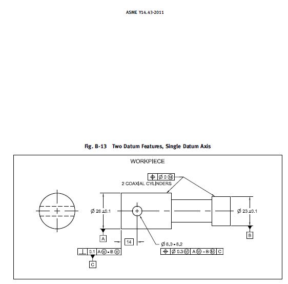

Sanity check: Are these two schemes valid in ASME?
Is they are kosher per Y14.5, then are they clear enough?

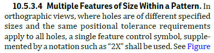

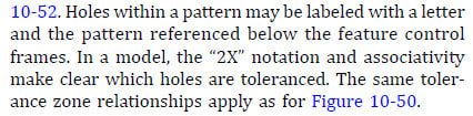

Multiple feature of size can be used as(Edited) a pattern per 2018 version section 10.5.3.4 Fig.10-52(or 2009 section 7.5.3.3 Fig. 7-51)
Season
Multiple FOS can certainly be designated as a pattern. Multiple leader lines are not introduced in Y14.5 as a pattern creation mechanism (Y14.5-2009 para 1.3.42), if the intent is to treat it as a pattern it must be accompanied by or satisfy one of these methods. Season - in the figure you introduced, as well as in the text, the notation "nX" is utilized.
As far as whether a pattern can be designated together as a datum feature(s) - as long as its clear what is being referred to I think its fine even if they are of different size, though of course each feature could be designated individually as a datum feature and referenced as a multiple datum feature ie: |A-B|. For example a position tolerance accompanied by "nX COAXIAL HOLES" with a datum feature symbol attached would be clear. A single FCF with a datum feature symbol attached which is part of a simultaneous requirement with several other FCF, and expecting someone to interpret that the entire pattern held in SIM REQT is your datum feature would be far fetched and unclear.

If 2X notation added on the 1st figure and followed the way of Fig 10-52, the two holes(with different size) will be a pattern, can we specify them as a datum feature? Edit: I will say yes in this case. Expect to see the valuable inputs from all VIP members, and I will stand corected.

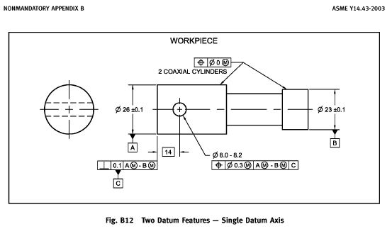

For the 2nd figure, the two coaxial features with a different diameter size, the multiple datum feature A-B will be more appropriate, this will be a slight different scenario from 1st figure, although they are all dealing with datum features.
What I focused is on the 1st figure, I think the OP's intent is: Can we use(or how to use) the multiple features with different size as a datum feature? Fig. 10-52 is just a method, we can treat them as a pattern just by adding a 2X notation, and then we can use the hole pattern as a datum feature. Please let me know if this logic is wrong.

I know a common datum feature A-B COULD be used, but my intent is to find
alternative ways and equivalent datum schemes to says the same thing (some people do not like or understand A-B common datum feature specially if you are using those as a datum feature.

Here is a quote from Evan, from a separate discussion, however I think relevant with the idea of common datum.
Question for the group:
Per Evan's input, what is datum A in the OP's second example? Is it the same as A-B case?
Otherwise stated if datum A is referenced as = A-B
and
datum B is referenced as A-B
are those two datum schemes equivalent with the OP's second case?
Again, based on Evan's input I do not think so.

What will prevent us for attaching/ hang a datum feature symbol to the 2 COAXIAL CYLINDERS feature control frame?
If nothing, then maybe the OP's initial solutions are valid, don't they?
