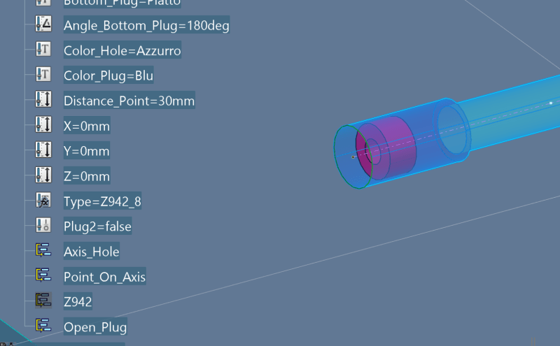

I have done a UDF with several output (look at the attached image).
Can I hide or show output feature by a reaction when i change plug parameter?

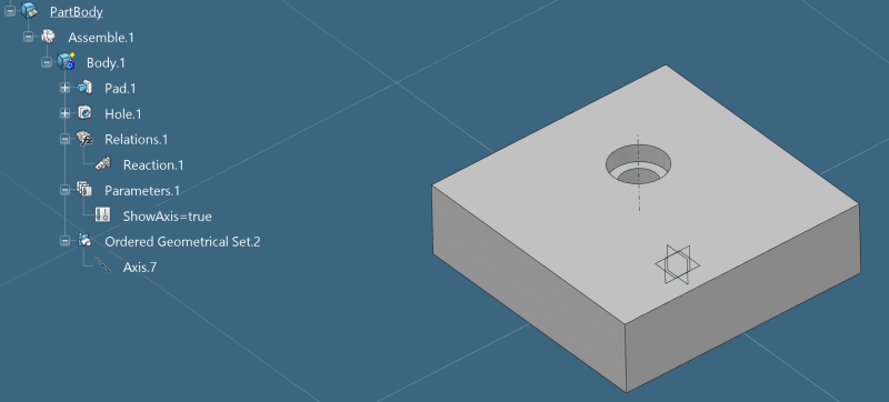

So what I did:
create a GeometricalSet or a Body (I used an Assemble Body)
in you GeoSet or Body make sure you have a parameterSet and a relationSet
create your boolean parameter in your parameterset
create the reaction in the relationset
in the reaction find the UDF with something like this:
Code:
let myUDF (UserFeature)
set myUDF =PartBody\Assemble.1.Owner
now that you have the UDF, go get the output but the trick is that when you create the code the first time you don't have the output yet, you did not defined the UDF yet... so Query the name you will give the output
Code:
let myList (List)
myList =myUDF.Query ("Line", "x.Name == \"HoleAxis\" ")
even if my line in the definition of the geometry is name Axis.7 I search the the output name...
Next is to Hide the Line
Code:
let myUDFOutput (Line)
set myUDFOutput  = myList[1]
myUDFOutput.Show = PartBody\Assemble.1\Body.1\Parameters.1\ShowAxis

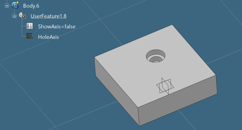

Now if you change your parameter it will fail and you will have error message because no line is named HoleAxis... not best solution but we're not done yet.

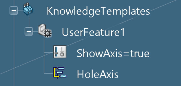

Create the UDF and define the output Line and name it properly and publish the parameter
in the UDF you can change the parameter and again it will fail... don't panic!
instantiate your UDF
change parameter and voila! it works. Etonnant non ?

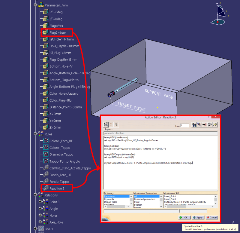

Hi itsmyjob
I don't Know but I can't write the code.
I have to do this with CATIA V5 R19, because some of our suppliers work with this version.
I attach the native file to the message.
Thank you very much.
Best regards
Carl77
the following code works for me.
Code:
set myUDF =PartBody\Foro_HF_Punto_Angolo .Owner
let myList (List)
myList =myUDF.Query ("VolumeGeo", "x.Name == \"Z942\" ")
let myUDFOutput (VolumeGeo)
myUDFOutput.Show = `Foro_HF_Punto_Angolo\Geometrical Set.2\Parameteri_Foro\Plug2`

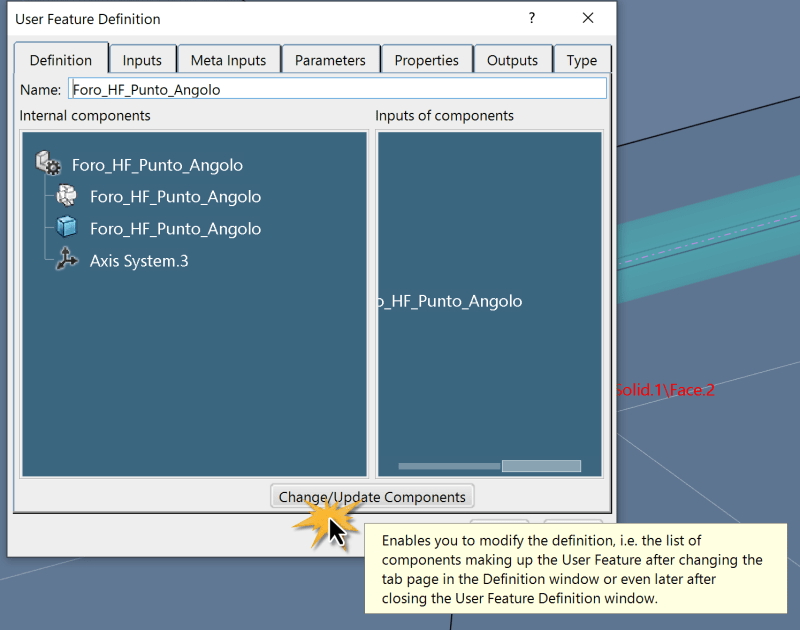

After changing the code I had to pass it to the definition of the UDF by updating the UDF
Also I published the boolean parameter Foro_HF_Punto_Angolo\Geometrical Set.1\Parameteri_Foro\Plug2
Result is fine:
Not sure why line 2 would fail. Remove all lines in your code, and add one line at a time to see when the problem is. I had some problem with some code before and the solution was to delete the Action or the Reaction and make a new one.
