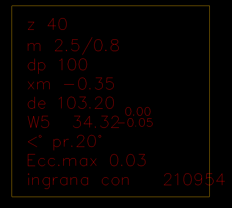

Hello All,
I just came by a different module size as m:2.5/0.8. I already asked to my hob supplier and they told me it is same with regular m:2.5 which I was not convinced. Is there anybody here who knows this or can give me a tip to look further.
Best Regards
Unable to verify that unless the mating gear data is given.
Here is the mating gear data.
please extrapolate the data to USA format
what is the center distance
what # teeth , Mod, & pressure angle
what is the SOP or TIF diameter
what circular tooth thickness? measurement over or between wires?
wire diameter?
or span measurement and # of teeth of span
are these both external mesh? or internal with external pinion?
Thank You
there are center distance calcs, with the above data to obtain tip diameters,
