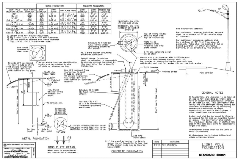

You may find this useful: Link.
By all means, do your own, project specific design. That said, I always start something like this by taking a look around the structiverse a bit in order to calibrate my what-looks-normal-o-meter. If it's good enough for IDOT, it's probably not too far off of what will work for you.

1. find a highway construction standard detail manual (MMCD in BC), that will size a precast post foundation based on the height of the pole. This will also dictate the bolt size and spacing. Something similar to what KootK provided.
2. Then check it manually. Determine loads in the bolts (wind is likely critical) and use appendix (appendix D I think) at the back of concrete code to determine bolt capacity / concrete failure mode.
