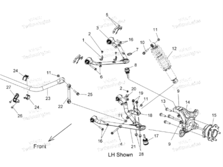

Per my last post, I am seeking to minimize spring rate without riding on the bumpstops. To do so, remaining wheel bump load available at laden shock travel must be greater than expected peak compression load.
I would greatly appreciate any review of the following. Excel attached.
Load Estimates
Brake: 1950lbm laden weight * 1g braking decel = 1950lb, divide by 2 front wheels = 975lb per wheel
Accelerate: 0-60mph in 5.5sec. (2.7g per second of 0-60) divide by 5.5sec = 0.5g * 1950lbm = 970lb on single rear wheel
Cornering at 1.02g???
Shock Sizing
Current unladen ground clearance is 6"; target unladen clearance is 5" = body should lower 1".
To find motion ratio, divide lower A-arm pivot to shock mount (13.5") by pivot to balljoint (16") = 0.84. 1" lower @ wheel = 0.84" shorter shock.
Current shock compresses to 15.5" unladen, subtract 0.84" to find new unladen shock length of 14.7".
New shock collapses to 11", stroke of 4.87" extends to 15.87". Compressed to 14.7" unladen is 75% compression travel (3.7"), 25% extension travel (1.21").
Unladen Weight
Total weight unladen 1740lbm; corner weight unladen 570lbm minus 60lbm wheel & suspension = 505lbm sprung.
Spring angle of 54deg. Find spring angle adjustment factor by SIN(54deg in rad); multiply by shock motion ratio of 0.84 = corrected spring motion ratio of 0.68.
Sprung weight of 505lbm at wheel divided by 0.68 = 740lb at the spring.
740lb divided by 212lb/in spring = 3.5" compression at zero preload. 15.87" extended shock compresses to 12.4".
Target unladen shock extension is 14.7", subtract 12.4" = 2.3" preload to extend shock to target ride height.
Laden Weight
Front corner weight when laden = 625lbm, subtract unladen corner weight of 570lbm = 55lbm of added passenger weight, divide by spring motion ratio of 0.68 = 78lb at the spring, divide by 212lb/in = 0.37" compression.
Unladen shock compression travel of 3.7" minus 0.37" = 3.3" (67.5%, nice!) remaining shock compression travel when laden.
3.3" remaining shock compression travel * 212lb/in = 697lb at the spring, divide by spring motion ratio of 0.68 = 1020lb available bump load at the wheel
1020lb available at the wheel > 970lb expected when braking at 1g

I'm actually hoping for review of the fundamental shock and spring geometry calculations. The load approximations are, as above, zero-order.

Regarding those wheel rates, or more specifically, the motion ratios, I am curious if the following is correct:

I can tell you what I've used:
Wheel Rate = Spring rate (a\b)^2 x (c\d)^2
a = Distance from lower control arm pivot to where the spring acts on the lower control arm
b = Length from lower control arm ball joint pivot to inner pivots
c = Distance from lower ball joint pivot to front suspension instant center
d = Distance from the center of the tire contact patch center to front suspension instant center
Example:
Spring Rate = 500 lbs.-in
a = 9"
b = 14"
c = 90" +\- 1\16"
d = 94" +\- 1\16"
Wheel Rate = 188 lbs.-in or a wheel rate at 37% of the spring rate
Assuming the same example above but the lower control arm is moved out 1". a and b are now 10" and 15". The Wheel rate is now 230 lbs. or 46% of the Spring Rate.
This is just an easy example and yes you can use the trig. Just remember it's at the lower control arm pivot point height. I would suggest doing it with a tape measure at first though to visualize what you're measuring. It also shows what's happening with un-sprung weight and how linkage effects it. This may also be why Norm brought up the contact patch? I cant speak for him.
Hope this helps.

I went to a Slingshot forum and tracked down some parts assembly prints and I hate to be the bearer of bad news but I think you're spinning your wheels. No one on the forum pursuing performance has solved the problems you're having. After reviewing the prints I can see why. I honestly couldn't believe it when I saw that the control arms are bolted directly to the frame and the pivot bosses are kept off the frame and adjusted with shim packs. You might want to ask Norm with his bike experience how to feel for developing vibration issues as you put some miles on your machine. Sorry to be so negative but I'm laying here recovering from an infected hip replacement with way too much time on my hands and found your questions interesting. Myself, if I didn't have them I'd get a tig welder, some chrome moly pipe, some plate and a tube bender and have a great time when I can get up and about with this virus in charge now. I also don't see how to send private messages on this site which I would have done.
I would think a spring angle (squared) effect would also be involved in the motion ratio, and I think that referencing spring angle to the vertical and using the cosine makes more sense because it's a vertical effect we're looking for here. Squared because the spring force has to be greater than the vertical force at the lower arm and the spring's axial displacement less than the vertical movement at the spring's lower arm pickup. Generally a small component of motion ratio (i.e. close to 1.0) for cars so the folks who seem to use cosine(spring angle) not squared aren't going to be off enough to much matter. Probably not negligible here.
So, (arm ratio) x (FVIC ratio) x (spring angle), the whole product squared for rate calcs.

Great explanation. Thank you. You're absolutely right about the spring angle but honestly, I have a hard time visualizing what I'm seeing compared to the actual skewed photos I can find leaving me with a lot of questions. Mainly the ball joints seem to be on a different axis. It's a relationship I'm not at all familiar with and I don't want to mistakenly offer bad information.
