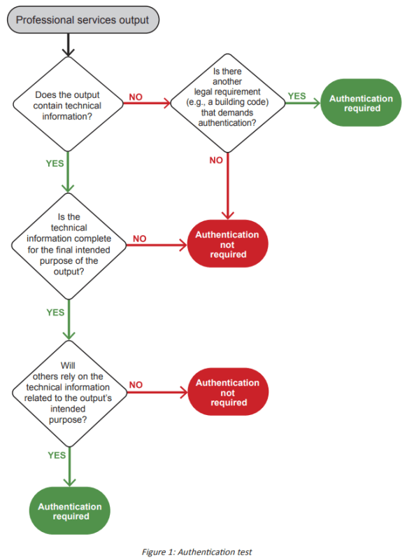

APEGA has recently released an authentication standard that includes a test for determining if an output requires authentication:
Based on the information you've given, the software likely contains technical information (presumably, equations/models that describe reservoir physics and transform inputs into engineering outputs), so the answer to the first question would be yes.
The software (and incorporated equations) is complete for the final intended purpose of the software (this is not a beta version of the software for others to review/test), so the answer to the second question is yes.
You mentioned that the engineering outputs of the software are intended to aid users in making [engineering] decisions, so the answer to the third question might be yes. This point could be debatable, especially if you add disclaimers that the outputs of your software should not be relied upon for making reservoir engineering decisions, but I would not be surprised if APEGA would answer it as yes despite any disclaimers.
One option would be to have another P.Eng. review and authenticate your software. This P.Eng. would be taking professional responsibility for it, so the review would have to be thorough and would likely be expensive, and may not be a practical option for you.
I would be very interested to hear APEGA's interpretation of the flowchart that jmec87 posted. I would be inclined to interpret it slighly differently at first blush:
Technical Information -> Yes
Complete for Final Intended Purpose -> No
I would argue that a software output is not complete for its final intended purpose. Engineers have a responsibility to validate software that they use. It's a tool that assists in their work, nothing more. If "engineering" is just inputting data, pressing the "run" button, and blindly relying on software outputs, then the profession is in a bad place.
Software outputs, in my eyes, are unverified results. These outputs must be verified, interpreted, and then summarized into a useful work product. That final work product is what needs to be authenticated (stamped). When an engineer authenticates a work product that incorporates software results, the engineer taking professional responsibility is not only taking responsibility for the software inputs, but for the software results as well. As a professional, if you don't verify your software regularly, you are taking some pretty huge risks.
This comes from a perspective of someone who uses software rather than from someone who makes it. I could be off base. Looks like you're a Newfie, maybe your regulator has practice advisors who could provide an opinion? I've used Alberta's and BC's practice advisors and they were helpful (especially BC's).
Per APEGA said:
A professional work product (PWP) is an output that requires authentication and validation. Defined in the General Regulation as “…plans, specifications, reports, or documents of a professional nature,” a professional work product (PWP) is any output of professional services with technical information relied upon by others, internally or externally, to make a decision or to take action.
Software, in of itself, is not "plans, specifications, reports, or documents of a professional nature," but its output is used to create such products. I think the burden of authentication on the "licensed professional" user of the software. Otherwise, any software tool relied upon by a licensed professional would have to be authenticated, including Excel, any CAD program, or any FE analysis/modeling tool, etc. Hard to imagine how much effort it might take to "authenticate" ANSYS, nor can I imagine any single PE's insurance willing to accept an open and unbounded liability risk for ANY error in the software that might cause ANY harm in an unbounded future with unbounded users
The out is APEGA's definition of authentication
Authentication (Physical and Digital)
Authenticating a PWP means an APEGA licensed professional has completed or reviewed the work and accepts professional responsibility for the engineering or geoscience involved.

This is PWP definition quoted from the APEGA standard:
A professional work product (PWP) is an output that requires authentication and validation. Defined in the General Regulation as “…plans, specifications, reports, or documents of a professional nature,” a professional work product (PWP) is any output of professional services with technical information relied upon by others, internally or externally, to make a decision or to take action. A PWP can be physical (e.g., paper, plastic film), electronic (e.g., electronic document,image), or digital (e.g., software, modelling, simulation, or any other computer application that cannot be reproduced in a physical or electronic format). See the authentication test in Section 3.1 when assessing whether an output is a PWP.
To me "make a decision or to take action" is ill defined being not sufficiently narrow. Some actions have impact some others not. For example, if I do check a pressure based on Excel spreadsheet calculation and based upon that output I would decide to call a vendor to double confirm the information, this is decision followed by action. But does this really need be controlled by regulatory framework? Now if I use a spreadsheet output to calculate some settings for a pressure safety valve, this is process safety related, it is different, yet constitute decision followed by action.
In regard to the statement of the APEGA specification that says: "relied upon by others... to make a decision or to take action". This exactly what my software is not: anything except a product to rely upon for making a decision. You already mentioned this point. So, if any user relies upon my software outputs, despite all disclaimers in place that they agreed upon by signing an EULA upfront, then I think it would be fair to say that the responsibility is entirely with the user and not with the producer of the software. If APEGA sees it differently, what is the rational?
But then, by extension, any excel template, say most basic one for doing rough calculations also falls under section 3 of the standard. Does this mean that all Excel engineering spreadsheet used in industry in Alberta is/has been certified/stamped by P.Eng ? ... And what about big software (IRStuff rightly mentionned ANSYS), for example Hysys Aspentech that is widely used in oil & gas, it contains massive, really massive number of procedures, how a review could be both conducted and be genuine at the same time (By the way, how the review is conducted is not precisely defined, what is needed to be verified? that the formulas/methods are acceptable to certain X standard that maybe does not exist or that the software has been coded conform to the formulas? I am not shooting the messenger, just sharing my concerns.

You've correctly pointed out that APEGA's definitions are quite broad. I've found a relative theme to this, at least in Alberta, with regulators expanding their jurisdictions as broadly as possible. It's probably a result of several factors, including the relevant legislative act not addressing limitations clearly, the heads of the regulators getting an ego boost by empire building, etc.
I'd call your regulator(s) and ask for a clarification. You've got plenty of cannon fodder from this thread regarding other software packages that are widely used in the province and that surely have not been reviewed and authenticated by a local P.Eng.
I would hazard a guess that software that meets the authentication requirements would be something like avionics software. Pilots take avionics output and rely on it wholeheartedly when flying under instrument conditions. They have no means (and no time) to independently verify the outputs prior to relying on them. I'd argue that's a distinguishing trait between software types, and a good litmus test for authentication.
The APEGA document is mostly concerned with software that's part of a product, like a building control/management SW.

ANSYS and other engineering software that has been engineered outside Canada might meet APEGA's definition of a "Commercial Off-the-Shelf Engineered Good", allowing it to be used by a Canadian engineer without authenticating it, unless you are incorporating ANSYS itself (not results from ANSYS, but the program) into your own program or are using ANSYS in a way that deviates from ANSYS's published specifications (see section 3.4.1 of the APEGA standard).
The PWP definition clearly includes "software, modelling, simulation, or any other computer application that cannot be reproduced in a physical or electronic format", so there is no general exclusion for software.
I agree that "relied upon by others ... to make a decision or to take action" is not clearly defined for this situation. The engineer is not directly relying upon your software to make a decision or take action. However, the engineer may rely upon the outputs generated by your software to make decisions or take actions. If the engineer wants unreliable numbers, there are free ways to get them without buying your software. What is the use of the software if its results cannot be relied upon?
But I realize that this "relied upon" is complicated. The engineer may use your software to generate ideas for operating parameters to try and then use other programs/calculations and their experience to decide whether or not to use these parameters. The engineer should not be blindly relying solely on the outputs of your software, but the engineer may be relying on the outputs of your software in combination with other simulations/calculations/experience to make their decisions and take actions. I don't know how to draw the line here, especially when you're selling the software and can't control (beyond the EULA, although you can't control compliance to the EULA) how it will be used. Maybe regulators will accept disclaimers in the EULA as a way to draw the line - I don't know.
I think that engineering regulators generally have not looked into this type of software in the past. However, as Craig_H stated, APEGA uses broad definitions and expands its jurisdiction as broadly as possible. If you ask APEGA about your software, I expect that they will say that it requires authentication, but the only way to know for sure is to ask them.
By the same token, the software under discussion is not a PWP, since it is not incorporated within any deliverable product, only its outputs.
Note that the wording "application that cannot be reproduced in a physical or electronic format" is not applicable to the output of the software. The PWP is clearly addressing a software deliverable, as indicated in the section I cited; a deliverable software needs to have documentation of source code, algorithm description, etc. The software in question is not a deliverable, per se.
