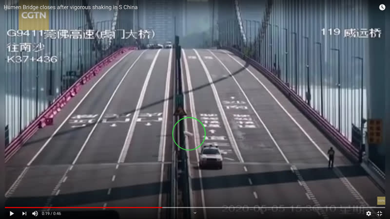

In the loosest sense, yes it is like Tacoma - wind+suspension bridge gives unexpected deflections. But Tacoma was torsional instability caused by flutter, this doesn't look torsional. Apparently the problem started after a new 4 ft high wall was added recently.
I imagine that is now being un-added.

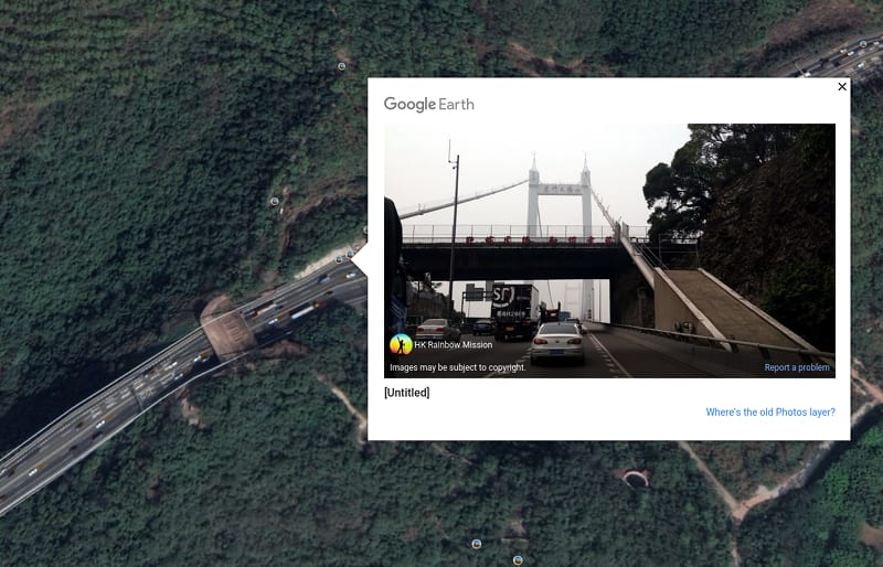

That's an interesting observation. I wonder if the sustained wind was diagonal to the deck somehow spawning vortex rolls down the length of the bridge? The geography of the greater area (22.793056, 113.608611) is flat river delta but the east end of the bridge is anchored in a rise of hills, which could create some interesting scenarios as well.
From Google Earth with 1.3x vertical exaggeration.
From above video at 19 sec. Note debris blowing in the wind.

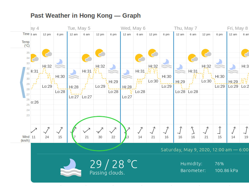

But that bridge is a long way from Hong Kong, maybe 130 km.
Sorry, I wasnt standing on the bridge at the time! ;)

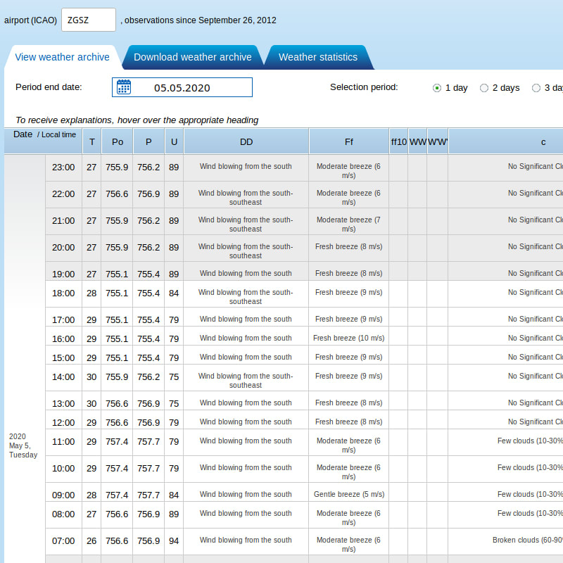

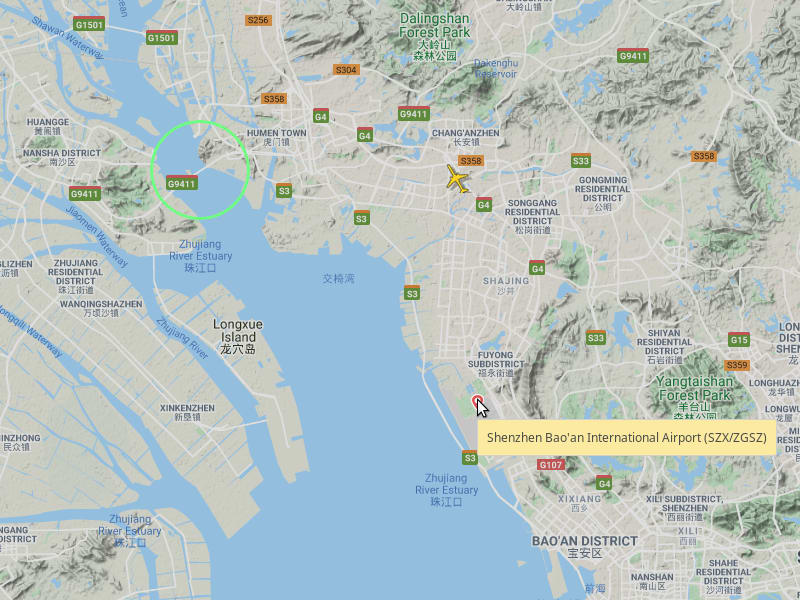

In case anyone is interested in the meteorology that caused this event, I found some better info. If anyone can improve on this with charts from the region, please do.
Generally, the wind was from the south, rising to 36 km/hr in the afternoon. The airport is located 27 km from the bridge.
Map from flightradar24.com.
From Google Earth and Wikipedia
Weather data from rp5.am.

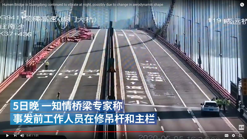

It appears that temporary safety barriers set out along the windward edge were indeed the problem. It is rather incredible, though not unforseeable, that such a small item could have such a drastic effect.
A screen grab of the barrier being dismantled.
From Youtube.
Looking closely the original barrier has spaces under and around it which was then blocked off by the solid barriers. Clearly enough to set up a different frequency of vortex.
And when you consider that the bridge is designed to withstand hurricane force winds, the winds that afternoon were but a breeze. I'm thinking there just wasn't enough leverage to pick up the leading edge w.r.t. the trailing edge. Or another way of analyzing it, the center of lift was too far aft, i.e. over the center of the bridge as opposed being closer to the leading edge.
