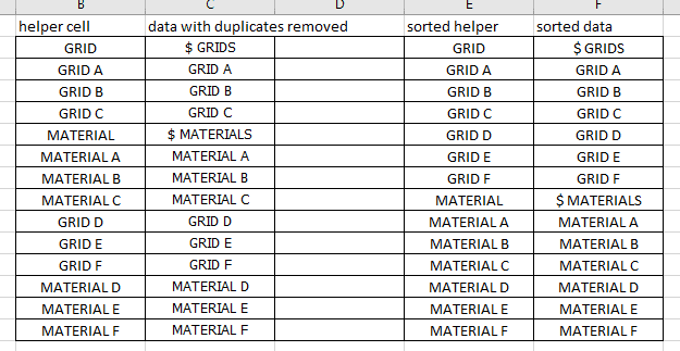

Here is a one liner solution that does it based on having a helper cell with the following formula.
=IF(LEFT(data,2)="$ ",SUBSTITUTE(LEFT(data,LEN(data)-1),"$ ",""),data)
this removes the leading "$ " and the trailing character enabling the data to sort using a
=SORT(data_plus_helper,,1)
data named range is your original data range with the titles
data_plus_helper named range is the data range and the helper column on the left of this
It will fail obviously if once removing the "$ " and trailing character if any two of the titles are then the same, but looking at your list it doesn't seem to be the case.
See attached file for the solution as easier to see it in action and understand the named ranges. Note you will need to be on the monthly Excel channel to use the dynamic ranges feature I believe (but I think it will back magic them into array formulas). If you are not on the monthly update channel you can do so quite easily by searching google.
Let me know if it worked.

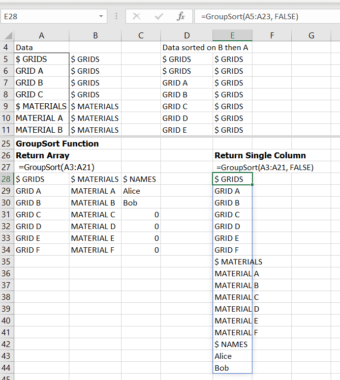

I thought Greg Locock was a bit hard on Greg Locock's solution, but just for fun I had a go at the VBA anyway (sample spreadsheet attached):

The function will either return an array (default) or a single column if ReturnArray is set to false.

For those with access to Excel 365 with the new Sort functions, the Sortby function combined with a helper column will return a single column of sorted groups, and the Unique function will remove duplicates, giving the same results as the second option of my VBA function:
For more details and link to latest download file see:
Doug Jenkins
Interactive Design Services
Hi Doug, your help is much appreciated. The GroupSort function worked really well, unfortunately it didn't place nicely with the software when importing the merged text file.
Unfortunately I'll need to manually merge these models - if only the software developer provided a product that worked straight out of the box!
