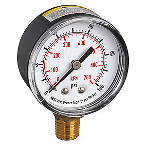

I assume the units are kPa, not pa, correct?
What is the maximum range/number on the gauge dial? 100 Kpa?
Is there a zero adjustment screw on it somewhere?
Are it a liquid filled gauge?

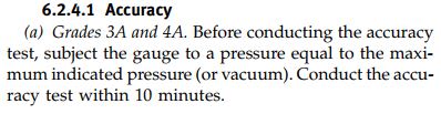

Is it standard practice to tap pressure gauges during calibration checks?
That depends.
-OR-
Brad Waybright
It's all okay as long as it's okay.
Yes, tapping the case is standard practice.
ASME B40.100-2005 Pressure Gauges and Gauge Attachments, in Section 6.2.4 Procedures allows tapping the gauge case lightly as part of the defined tests for accuracy, repeatability and hysteresis.
Hi All,
Sorry, I should have specified! The gauge itself is a room differential pressure gauge.The instrument itself has an accuracy of 0% at test points 0 and 30 Pa. However, it seems to be out of tolerance by 5Pa at its maximum pressure of 60 Pa. The differential room pressure never exceeds 20Pa and the gauge itself is only about 5 years old. Sorry for the confusion.
