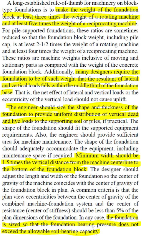

It depends on what your definition of dynamic equipment is. It probably is, but it's probably light enough that the foundation can just be designed per the "rule of thumb" method.... If the foundation weighs 4 times the weight of the equipment then you should be good. Three times may be good enough. Some of the 'rules of thumb' vary slightly.

Except gas turbine generator in the powerplant, I consider the generator is a vibratory machine rather than dynamic equipment. It would be the best if you know its frequency range, otherwise, the 3-4 times "rule of thumb" is the way to go, but can be proven wasteful later.

The image shown below is from the ACI 351.3R-04 Foundations for Dynamic Equipment. If the natural gas generator does qualify as a 'rotating machine", then my goal is to adhere to the design criteria shown in the image below:
I would most likely use 3 times the weight of the generator, based on the information contain in the image.

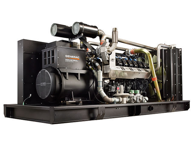

The sensitivity of these will depend on how many kW the unit is. Little ones like the one in the image are designed for the most part to be skid out to a remote site, attached to a light foundation, and fired up. Big models are different. If this is for your other project, I doubt it is a monster generator. I know of diesel fuel generators operating much larger sites. Those bear on some relatively small piles. If the unit is large and very expensive, you need to find a consultant that specializes in dynamic analysis. The general rules of thumb are inadequate for many.

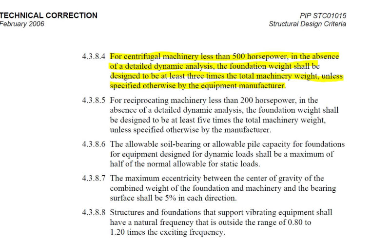

The only place I have been able to locate the mentioning of the amount of horsepower of the machine to warrant a dynamic analysis is in PIP STC01015 - Structural Design Criteria. Please see image below:

The natural gas generator for this project is 450 kW. This a different project from the one in the other post.
Just realized that 450 kW equals 603.46 hp.
I guess I just determined that a dynamic analysis is required.

That being said your 600 hp generator is probably on the edge of "needing" an analysis. That being said, does your client have specifications? If so, they may have guidance on whether a dynamic analysis is needed. Many or our clients don't want dynamic analysis even for large pieces HP pieces of equipment. They ask we use the prescriptive weight requirements of 3-5 times the weight of the piece of equipment.
