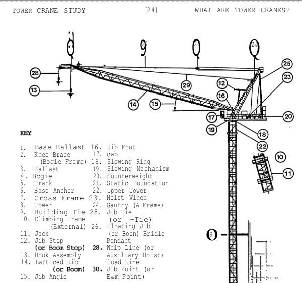

One part is pivoted from a fixed member, in the illustration midway on the top of the machinery housing, and the other part is pivoted to the boom.
The two back stops look like hydraulic cylinders.
They may stop wind events but given the violence of this event they would not have helped.
The tower or gantry would have acted as a back stop, but the upward reaction was so powerful that it bent the boom over the tower.
Conventional telescopic stops low on the boom would have been much less effective.

At one time jibs were protected by a cable system.
A strut was pivoted near the pivot between the main boom and the jib and swung below the pivot.
Slack cables ran from a point on the main boom through the end of the strut and to the jib.
The cables came tight when the jib reached the maximum allowable upward position.
These systems seem to have fallen out of favour.
On a large crane they may do more damage to the jib than they prevent.
Bill
