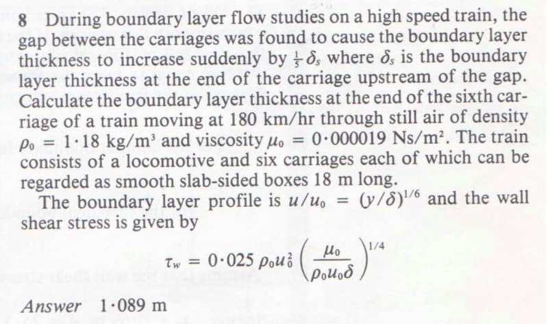

I did a Civil Engineering course some years ago and from my textbook I have an attached scan of the question on boundary layer for a train, that I have been trying to solve, but haven't.
Based on boundary layer profile and wall shear stress given, I have come up with an expression for boundary layer thickness. I can go into the calculations later for that, if needed.
I don't unfortunately have a way of putting the symbols up, but I'll explain what I have so far and why I can't get to the answer of 1.089 m.
Boundary Layer Thickness for one carriage = (0.233 * 5/4)^4/5 * (viscosity / Air Density * Train Speed)^1/5 x^4/5 where x = carriage length = 18 m
Boundary Layer Thickness for one carriage = (0.233 * 5/4)^4/5 * (0.000019 / (1.18 * 180/3.6))^1/5 * 18^4/5
Boundary Layer Thickness for one carriage = 0.189 m
There are 6 carriages and a locomotive and there is a gap in between them.
From the question it says that the gap between the carriages was found to cause the boundary layer thickness to increase suddenly by 1/5 of the boundary layer thickness at the end of the carriage upstream of the gap.
Now how do I go from here to get 1.089 m ? If I multiply 0.189 * 6 and take into account the gaps, it is more than 1.089 m
Do I need to use some sort of integration between some limits to work this out ?
I am stumped as to how to get the answer from here, need some help.

where does your BL thickness equation come from ?
notice that BL is not directly proportional to length, hence not "6*"
how does the BL respond to the 20% increase due to the gap ? At the start of the 2nd carriage it is thicker than it "wants" to be, does it …
1) continue increasing as though nothing's happened ? (but then it is inconsistent with the BL thickness equation?)
2) stay this thickness until "x" along the carriage ? ("x" is the length for the 20% increase)
3) fall to try to match the BL equation ??
how to use the wall shear stress ? (or is this a red herring ?)

"If I multiply 0.189 * 6 …".
this is wrong as …
1) train + 6 carriages = 7 (not 6)
2) BL thickness is not linear with length (from your equation, BL depends on "x^0.8")
3) can you show your work, derivation of BL thickness ?
4) how does the BL respond after a 20% jump ?

lets start with the 1st carriage.
at the end of the train the height of the BL is "easily" calc'd. In my experience the BL height asymptotes to some height, based on free stream velocity, shear stresses, blah, blah (i'm not an aero guy).
The key question, and one I don't think we can easily answer, is how does the BL respond to the 20% step due to gap between the carriages ? Should the "x" for the BL height be the distance from the nose of the train ? Is the gap a known distance (1m) ? But the 20% bump causes the BL to be out of step with what "x" would want it to be. So does the BL …
1) keep growing as a function of x ? (not likely IMO)
2) stablise at the 1.20 height until the BL equation exceeds this ?
3) fall to what the BL equation wants ? Clearly not immediately ('cause then the 20% would disappear from the problem)
But wait, if over the length of the next carriage the BL exceeds the 20% bump then you don't care about it ('cause your equation for BL height will exceed this bump, if BL height is a function of "x")
Why do you know the BL is not based on a length of 127m ? (this is not BL height at 18m *7)

BL eqn depends on "x". what is the datum for "x" for the second carriage ? (not the start of the carriage, if the start of the train, what distance for gap ? (possibly assume negligible)
"I worked out boundary layer thickness at end of first carriage = 0.189 m and with 20 % added on for the gap that gives you 0.2268 m." … understood
"What I am confused about is how does it work from there, going to the second carriage and the ones after that." … yep, that's the crux of the matter ! How does the BL respond if it is "too big" (due to the 20% bump) ?
If the train were one long carriage, you could easily calc the BL height (for x = 127m) and it's not 7*0.189.
Perhaps you calc BL for 14m and if greater than 0.2268, then you use that; else BL is 0.2268. Then the 2nd gap jumps the BL to 0.272m. etc
