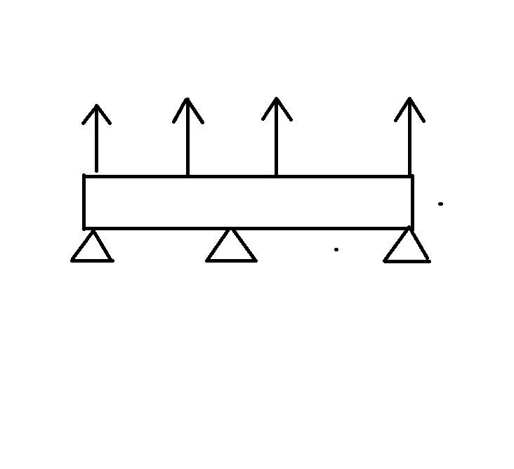

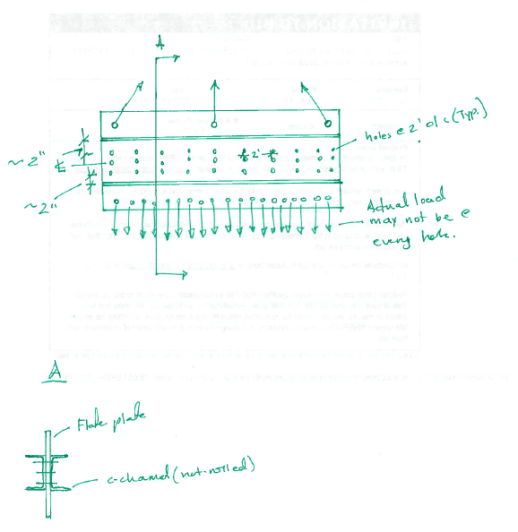

I have the below scenario: How do I resolve the force being applied to the welds given a max shear and a max moment (developed from shear-moment diagram).
The orange dots represent locations of the fillet welds. Channels are 15" deep. plate is 36" deep.

It depends on the support conditions of your beam and how the load is applied. The centroid of all your sections align, so there is no shear flow in the welds. I think you just need to deal with the local effects at the supports and where the load is applied.

Load is being applied to the plate only. Top and bottom. Lifting device. Creating tension/bending in the plate. I am attaching the channels to the plate to prevent buckling. What I am wondering is, what, if any, loads are being applied to the welds, and if so, how can I quantify them?
RE: Welding on a Beam
The plate sounds really deep for a lifting device. I assume this is to resist the bending stress in the plate? Personally I would go with a conventional lifting beam that you can evaluate with standard methods and weld on gusset plates for lifting eye's.
Is there some reason you have to go with plate / channel design?
Ideem,
Yes we have the channels and plate readily available (on site). So, I'll need to use this configuration.

JD20, I didn't see that this is part of your other thread. You had a nice sketch of the beam in that thread that would have been good to include here (I've included it below).
There might be (probably is) a more rational way to approach this, but I would be inclined to take 2% of the your strong axis moment, apply it as a weak axis moment, and design your welds accordingly. As Craig_H pointed out, your channels will take some of the load based on their stiffness, and that load will have to get transferred into the channel along its length and then back into the plate near the support points.

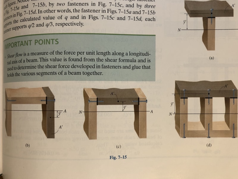

retired13, none of those examples show the component in question crossing the NA. The illustration looked familiar, it’s the same as my mechanics of materials book (Hibbeler), but I have an additional figure. See below, figure (b).

Interesting. How about case (c). Actually, I don't think about component, but treat all parts togather as a single unit, then decide the location needs to be investigated/connected. Simple check is that, for a rectangular shape, the maximum shear is at the mid-section, where Atop & Abot are maximum. Anyway, it just provided for your information.
Now I realize (b) demonstrates the case with the centroid of the leg is offset from the NA of the built-up section, thus, Q=A'*y'. If centroid coincident with NA, we can't use take this short cut, or this method, then we need to use (c), if the location shown is the interest. But does not mean shear flow is zero. Find an example for square built-up section, you will know what I mean.

What is the difference between the shear flow calculated in my sketch and the shear flow calculated in your book's figure 7-15 c and b?

Can someone break down how you convert a moment to longitudinal shear?
We're talking about the shear flow between the channel and the plate - your calculations were for shear flow between two portions of the plate...completely different plane, you're at the wrong location.
Quote (Johns20188)
It doesn't matter that there's no differential bending stress along the flange, there's still shear flow since there is still bending stresses (there's still shear flow in the flange of an I beam even though the flange bending stress is constant along the flange).
I agree with this, but we're not talking about a beam section made of 3 plates with offset centroids, we're talking a plate and 2 channels all aligned. It makes a difference.
Say for example you had two beams - one is solid 6"x6" steel and the other is a collection of 6 plates 1"x6" stacked vertically side by side but not welded together. If the plates are loaded on the top edge and bearing on the bottom edge, both beams will have the exact same strong axis bending properties and the exact same stress profile, there is no weld required for the loose collection of plates to behave the same as the solid square beam (because their centroids all align). If the loose plates were stacked horizontally (offset centroids), then you would now require a weld between layers of plate to achieve the same properties.

Your sketch in the other thread showed your slings inclined which will induce significant compression in your beam, has that been considered?
USA. Yes they induce 12.5k max in axial compression. I checked this incorporating area of section and it yielded a KSI below the allowed (computed from the formula provided by BTH)

Quote (steveh49)
Agent, my turn to be wrong or misunderstanding you. Apply your argument to a typical 3-plate I-girder where there is shear flow in the welds to create the composite section. The stress at the top of the web is the same as at the bottom of the top flange. It's not the stresses at a single section; it's difference in stresses at sections separated by a short (infinitesimal) distance along the beam that result in the weld stress.
I think shear lag means the central plate acts as the web for half of the flange width of the channels (or maybe more given the load application). It's better placed geometrically than the channel webs.
Edit: This forum need a serif font so "I girder" looks like an I girder!
I agree it's the difference in moment between two points that causes the shear flow. Another way of expressing the change in moment along the length is by saying V ∝ dM/dx......... i.e. the change in moment is proportional to the shear. We know shear flow is proportional to the shear flow. Nothing to do with longitudinal stresses derived from bending in a beam as some people were suggesting.
With an I girder, it fundamentally a different beast to what is being proposed here. The compression force in the top flange (say) has to transfer across the weld to resolve with the tension force in the bottom flange. For the symmetrical section about the centroid proposed, this is not the case. Load in channel can resolve through the channel web and doesn't necessarily need to go through the plate. There are effectively two sections placed beside one another constrained to the same deformation. I believe as others have said that if the centroids are all aligned for the different bits of steel. Then there is no shear flow.
I did some more thinking on this while I was sleeping which can be dangerous. What you have got is three bits of steel constrained to the same deformation with centroids aligned. With all the load being introduced via the plate to the system. One way to think about this scenario is that the loads are shared based on relative stiffness, work out the relative stiffness and you know the loads going between each member, size the welds for this vertical force. You have the added complication of getting the loads out at the ends of the channels.
It's fundamentally no different than making a flitch plate out of timber/steel/timber plies. Provided that the centroids are aligned, there is no shear flow. It is simply some members with dissimilar stiffness sharing a common load. Once you know the stiffness and how the loads are transferring between members and introduced to the members you can design fixings between the plies to carry the proportion of the load required to each member and follow the loadpath required for equilibrium

The sketches below show how I'd tackle this if were a real problem crossing my desk. Go forth and be profitable my friend. Expend your serious mental horsepower on some problems more worthy of it.

I think we've gotten quite caught up in semantics around shear flow here. Trying to put that aside, and in light of the OP's beam dimensions now being clear, I will provide some input on the design of lifting devices such as this one. I have designed several and analyzed them for more load cases than I can count. Generally, here is how I have approached these multi-hole lifting beams:
- It is often easiest to have a central plate provide the vertical shear capacity, and have it protrude above and below the lateral bracing portions of the cross-section so that you can drill holes and use those portions as lugs. That is perfectly vanilla.
- These devices are susceptible to both local and global buckling. The protruding, unbraced webs often limit the allowable stress due to their tendency to buckle locally. Because your top slings are not vertical, your lifting beam is exposed to combined compression and flexure, making it susceptible to global buckling (KL/r stuff). There's a double whammy with the flexure as those angled top slings both impose compression and additional flexure due to their eccentricity relative to the beam neutral axis.
- Due to the susceptibility to global buckling, I have always designed these devices to be quite laterally stable. Use closed circular or rectangular sections to prevent LTB sensitivity. Make these portions significant so that the beam is stable, and you can also utilize them for additional flexural strength. Your central plate should not constitute the majority of your Ix. A typical cross-section (with lug holes shown) is shown below:
- I take the weak axis design quite seriously. There's potential for a suspended load to shift or induce slight lateral loads on the beam, which we know is susceptible to global buckling. I have generally designed the weak axis stiffening elements to be able to yield without splice connections or welds failing.
OP, if you haven't written us off here, you might want to reconsider your choice of lateral stiffening, and choose something that maximizes the geometry of that stiffening (such as shown in the image above).

Thanks. Let me throw this out there... thinking about changing the section to the following so the compression will, without a doubt, be transferred to a wide flange:

JP20, the channels can't easily be positioned that way - you're going to have a decent size fillet weld between your two 1.25" plates and the channel won't fit there unless you notch the top flange. If you really need to make this work with the material you have on hand, I believe this is your best shot - turn your channels into flanges and use the 1.25" plate as the web. The channels give your compression flange great Iy properties. And I think this gets us back to a shear flow condition that we can all agree on. Please review the list of topics from my previous post - I feel as though you're still missing key concepts required to make this a safe design.

Quote (JP20)
I would give some serious consideration to something like Craig's recommendation, repeated below. Not that it necessarily has to be ac circular section etc.
While it may not optimize your material costs to the nuts, one very simple way to shed the complexity involved with this stuff is to design yourself a cross section that would work for both strength and stiffness even if it did roll over in lateral torsional buckling. Flip the thing sideways and make it work that way as a beam column.
Obviously, that makes for a section with a lot of weak axis meat to it. But, then, you've got a fairly simple and reliable solution that you can execute without too much fuss.
One problem with your current section is that, with your three point support condition, sometimes the compression flange will be the bottom flange. In that case, you'll have your edge stiffening on the wrong side.

The beam is 40' long, with 3 slings on top and multiple lift loads below. The channel wasn't sized, but an attempt to prevent buckling.
