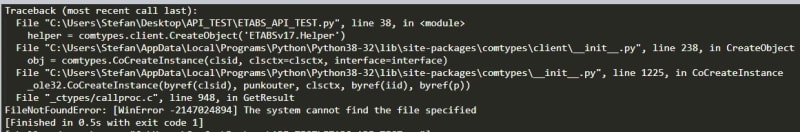

Hello all,
i'm new to Python and Etabs API. I'm trying to run the API example from CSi, but every time i'm running the code, i get the following error:
I've tried to delete and reinstall the "comtypes" package but it doesn't help.
Any idea why does this error happen and how to fix it?
Probably best to start a new thread with questions than to add to existing threads.
Can you please confirm the following:
- Which python development environment that you are using (eg. Spyder).
- Which version of Etabs you have installed.
- Which version of comtypes you have installed, you will find this in the comtypes\__init__.py file.
- In the etabs install folder, what .tlb files do you have. Looks like you are using etabs v17, are they 'CSiAPIv1.tlb' and 'ETABSv1.tlb'.
- In the comtypes/gen folder, there should be some files that have been generated, open these files in a text editor and do they reference these tlb files.
Try opening etabs and running this script.
Python:
import sys
import comtypes.client
try:
    myETABSObject = comtypes.client.GetActiveObject("CSI.ETABS.API.ETABSObject")
except (OSError, comtypes.COMError):
    print("No running instance of the program found or failed to attach.")
    sys.exit(-1)
SapModel = myETABSObject.SapModel
Hi rscassar,
- i'm using PyCharm
- Etabs 17
- comtypes version 1.1.7
- there are 3 .tlb files "ETABS.tlb", "ETABS2016.tlb", and "ETABSv17.tlb"
- there is reference only to ETABSv17.tlb
After doing this i get the following Error:
Traceback (most recent call last):
File "C:/Users/Stefan/PycharmProjects/ETABS_API/TestFile.py", line 9, in <module>
AttributeError: 'POINTER(IUnknown)' object has no attribute 'SapModel'
Process finished with exit code 1
Thanks for your help.
