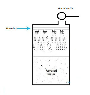

Hi itsmoked,
I should have rephrased my initial question better. I am just curious to see how much of air
is able to mix with the water. Would you suggest using a anemometer at the top of the vessel
as the best option? Thanks again.

The amount of air that gets entrained into the water will be tiny. The more practical way of detection is post facto; I would have a shield of some sort that can be slid into place, just below the surface of the water, and wait for the air to come back out. Obviously, the water needs to have been still for a while before the test as well.

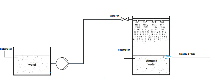

Hi Compositepro,
I'm not too sure what you mean by counting the bubbles coming out of a tube. Is there a diagram to help me understand this?
Also, I was thinking of using a rotameter instead, would this be more feasible? I have remade my initial experimental setup
based on the recommendations provided. Would this be a more practical setup? Thanks in advance!

'poligies for the delay, O2 is the cheapest, but with gas chromatigraph you can measure all the components.
That said, if you want total gas absorption for given conditions, you take a temperature controlled sample for a fixed volume and measure the density, or pull a vacuum on it and measure the gas density of the gas. Pleantin of manufacturers out there for example: Density range 1-400 kg/m3(0.001-0.4 g/cm3)
Good luck,
Since you're aerating the water with air, the dissolved oxygen is a representative component; besides oxygen, there's nitrogen, CO2, and argon all accounting for over 99% of air.
TTFN (ta ta for now)
