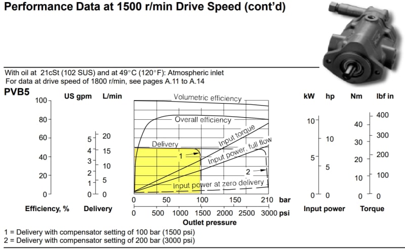

I agree with hydtools, as long there is enough power in the prime mover the pump should deliver max flow up to pressure cut off. (the diagram shows a rounded corner though)
Here is a Vickers pump with specs that look more like the one on the video, with only a max pressure compensator for max pressure stand-by. Hydtools pump also had a low-pressure stand-by compensator, but the principle will be the same.
So this pump thrives to maintain compensator pressure setting till swashplate has reached its max angle. If you ask for more flow at that position it will result in an instant pressure drop. So the flow has to be controlled with a directional valve variable orifice and of course the load pressure downstream the orifice. On the detailed schematic, it seems like the bias spring is "adjustable" or replaceable for other pressure ranges(??).
According to the catalog specs the pump delivers full flow at all pressures less than the compensator setting. That has been my experience, too.
This can't be so. The pump can't go instantly full stroke when it drops one psi below the pressure set point. This would cause an unstable response.

It looks to me like the pressure change A is 40 psi so if I have the compensator set for 1500 psi then I get no flow at 1500 psi but at 1500-40 psi I get close to 100% flow minus the droop of up to 1.2 gpm.
It looks like the pump flow vs pressure goes up the right side of that pump curve and it looks linear. In my case it looks like if the pressure drops 20 psi to 1480 I will get the rated flow minus a little for the droop and and divided by 2. Basically the pump performance is going up and down the right side of the pump curve.

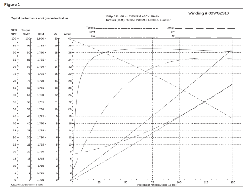

We tested an HPU a few months ago. We measured current with the swash plate neutral, pump in pressure-compensated state. For reference, full load amps was 57 per motor datasheet. Measured amps was 25. I had found a US Dept of Energy document that had some generic curves for Efficiency and Power Factor when at much less than full load. Using approximate Efficiency and Power Factor from that document, and applying the motor equation P = V x A x Eff x PF x 1.73, I calculated that the motor was still outputting 15 HP. It was spinning at say 1750 RPM, so:
T = 15 HP x 63000 / 1750 RPM = 540 lb-in.
Full load torque per motor datasheet was 148 lb-ft = 1776 lb-in.
So in the pressure-compensated state, the motor was still needing to generate a good amount of torque, ~30% of its full load torque per my calculation.
Another way to calculate it, simpler but probably not as accurate: 25 Amps / 57 Amps = 44% of full load torque.
The slip will be smaller.
I agree. So you can interpolate between 1750 RPM and 1800 RPM for say 30% or 44% of full load torque (if you want to use my numbers above).
I wonder if slippage is taken into account with the volumetric efficiency.
Speculating that they probably measure the RPM of the pump shaft or the motor shaft with a tachometer or other device, measure the pump output flow and pressure, and calculate the volumetric efficiency for the different pressures. So they're basically saying, 'if this is your pump discharge pressure, this is your volumetric efficiency, regardless of what speed the motor is at'. I hope that makes sense. I don't see them trying to calculate motor slippage and then using that for their input RPMs.
I want to add that other pump manufacturers actually publish motor power required in the pressure-compensated state. Using that power figure and speed, you can calculate torque and compare to the full load torque to see where you are speed-wise. From one of the pump mfr graphs that I saw, the power was quite a bit less than the 15 HP that I calculated for the pump we had, for a comparable size pump. I want to say it was like 5 HP, so a lot less torque, therefore much closer to the synchronous speed of 1800 RPM. If you want me to point you to where I saw this in one pump mfrs catalog, let me know.
Current measurement is a poor indicator of power output of a motor. The efficiency of a motor at no load is about 0%.
Hydraulicsguy, the current generates torque but if the motor is stalled then there is no output. It is similar to dead headed hydraulic systems, if no work is being done then there is no power generated, just heat. Power = Torque * radians/sec.
