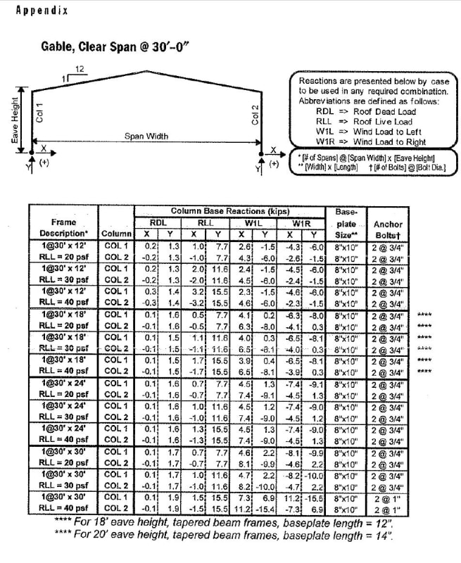

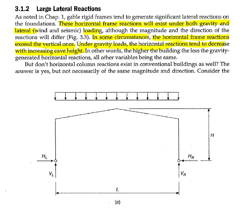

The images below are from the Foundation and Anchor Design Guide for Metal Building Systems book
-Looks to me like this would be a standard open building designed under ASCE 7, and I'd think that wind uplift on the roof will probably control your anchorage design. Unless this thing is heavier than it looks and you're in a very high seismic region.
In the past when I have designed foundations for pre-engineered metal buildings their horizontal reaction forces were greater than anything i ever came across in typical conventional steel building. Regarding the wind uplift playing a significant role of the anchorage design,you are probably correct.
-Depends on what your anchor reaction forces are, what your edge distance is, and how deep your mat footing is. It seems likely to me that you could avoid them unless your edge distance is very small.
I am hoping to use either 6 inches or even 12 inches from the edge of the mat foundation to the nearest anchor bolt center-line, for the edge distance.
-Depending on what kind of equipment it is, it seems likely that mat will be sized based on that and you'll have plenty of capacity and anchorage depth for your relatively lightly loaded canopy columns.
The equipment skid are the largest weight on the proposed mat foundation. I am certain that they will govern, but I want to consider the effects of the pre-engineered canopy on the mat foundation, as well. I have only ever designed pre-engineered buildings for Slab-on-grade foundations supported by ether drilled piers or spread footings. I don't believe a mat foundation would have a problem, but I just wanted to get some thoughts on the matter in case I am overlooking something.

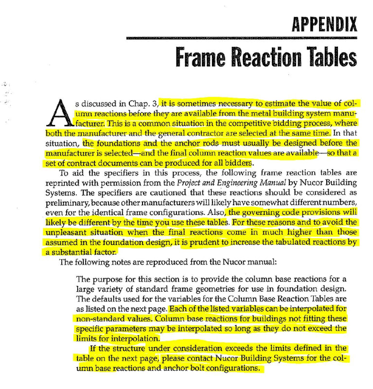

I have been reading through the Foundation and Anchor Design Guide for Metal Building Systems and it appears the Appendix called "Frame Reaction Tables" talks about reactions to be used for the situation that i am in and what you described.
Here is what the Foundation and Anchor Design Guide for Metal Building Systems says on the subject:
Can anyone comment on experience using the information I mentioned form the Foundation and Anchor Design Guide for Metal Building Systems book, regarding the column reactions?

The Appendix in Foundation and Anchor Design Guide for Metal Building Systems book gives some preliminary values for the horizontal dead load reactions:
It also talks about modifying the values, as well.

The primary aim is to get a preliminary (slightly conservative) design for the foundation and anchors, so that the GC has something to estimate the quantity for bid.

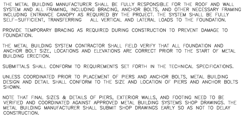

Once the project is in construction and a Pre-engineered building contractor is selected, they will run their design and provide you with reactions at the base. The numbers you estimated during design should be in the ball-park to avoid a significant redesign of things at this stage.
I usually add some notes on the drawings to cover the requirements:
During construction,we had to sometimes push the GC to get us the reactions from the Pre-engineered building contractor ahead of time so that we can review them and make any changes to the foundations if required, prior to approving rebar shops.

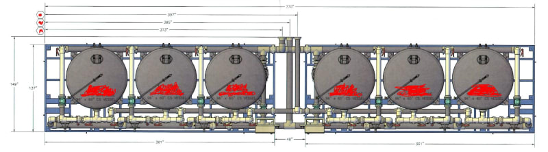

The reason I am using a Mat foundation is for the @ equipment skids located under the canopy (see link: )
The foot print of the equipment skid is as shown in the image below:
[ADD] THE SKID FOOT PRINT IS 770" X 137".

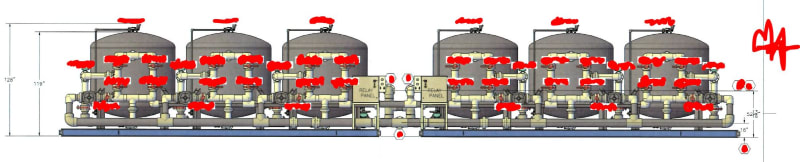

The elevation view of the equipment skid is as shown in the image below:
[ADD] THE HEIGHT OF THE EQUIPMENT IS 128".
As you can see from the elevation and plan view the equipment skid will be rather large. There are 2 of these skids contained inside the canopy. The skid shown has a total operating weight of 40 kips.
I have never heard of a equipment skid supported on a slab-on-grade w/grade beam foundation, so i believe that a mat foundation would be appropriate. I then obtained parameters to design a mat foundation from the geotechnical engineer.
I would think that a thick Mat foundation would allow for all anchor bolts to be installed with enough embedment.
Please let me know if there is another way to go about this.
Those are not very heavy skids. It looks to me they need roughly 16 bearing points per skid. If the skid vendor has indicated the bearing points one could conceivably install on pad/piers, but if you have poor soils the mat fdn will perform much better. I assume the skids are elevated off the slab.
If your client is okay with the mat foundation, and would like the option for heavy loads in the future, by all means, that is a great design. We have seen many thickened edge slabs for this type of application as well.
