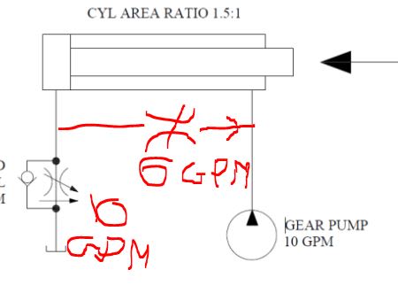

Please see the simplified hydraulic circuit below. Many components not shown for simplicity. For now, this is just a thinking exercise and not an actual situation.
Cylinder retracting. Gear pump putting out 10 GPM pump flow to rod end. 10 GPM is its absolute maximum flowrate at motor absolute maximum RPM. 1.5:1 cylinder ratio. That means flow from cap end would normally be 15 GPM. But pressure-compensated flow control is set to 16 GPM. Overrunning load acting on cylinder attempting to push fluid out of the cap end as cylinder retracts. What happens? I think flow from cap end would be 16 GPM. Pump is not able to fill up the rod end fast enough, which would require it putting out 16 GPM / 1.5 = 10.67 GPM. Pressure at rod end would drop to 0. Pressure at cap end is load-induced pressure. Cylinder retracts at a speed equivalent to 16 GPM. Am I thinking about this correctly?
This is a way to control the speed of the cylinder as it retracts with the overrunning load, while avoiding a pressure intensification situation. Any downsides? If the pump can't fill the rod end fast enough, is that a problem?
With less than 0 gage pressure in the rod end, the rod seal may allow air to enter the system.

Could you have two flow controls?
One set at <10 as shown and the other at >6 but feeding back into the gear pump inlet line with a check valve in place to only allow flow in one direction?
OP here. To those who say negative pressure and cavitation will result - isn't the fluid in the rod end of the cylinder at atmospheric pressure? The fluid is flowing into the vacant rod end and almost able to keep up, just not at any meaningful hydraulic pressure. Why wouldn't the pressure in the rod end be 0 psig, or 14.7 psia? And the pump discharge pressure is still above atmospheric because of pressure drops from pump to cylinder.
I'm not sure I understand fully. You mean two flow controls in series back-to-back?
"Almost able to keep up" - Yes, but not able means there is a volume deficit between the cylinder movement and the oil flow in. That needs to be accommodated somehow to preserve mass - result the piston pulls a vacuum.
If mass flow required by the volume created in the piston space isn't filled with oil (almost keeping up) then what is it filled with?
Does that make sense?
NO I mean add a horizontal line between your two vertical lines between the cylinder and the controller and insert a flow controller in there with a NRV (flow left to righ). Make that 16 gpm one 10 gpm and make this new one 6 gpm.
The in effect the balance of the oil (6gpm) is simply being transferred from one side of the piston to the other.
So two flow controllers in parallel, but feeding different end points.
See my terrible mark up below.
AS long as we understand what you mean the "mark up" is OK. It's called "effort" [cook]
But what do you do with your additional "flow orifice" when you extend the piston?
There should be a no return valve added to allow flow from left to right only. I ran out of space...
The issue I see about the nrv as shown is that it leaves the return uncontrolled.
