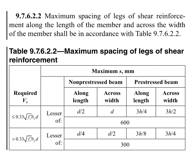

Greetings,
AS per this thread link
https://www.eng-tips.com/viewthread.cfm?qid=397909...
Majority of engineers refer to ACI 318, 11.4.5 and state that transverse stirrup spacing shall be as prescribed in 11.4.5.1.
In my opinion, ACI speaks about spacing of stirrups perpendicular to longitudinal axis of member which is vertical axis and it specify vertical stirrups spacing(S) not any horizontal spacing of stirrup.
Lateral spacing is of no concern since we calculate "Av" which itself depends on width of beam"bw" More wider beam will need more Av.
Would any engineer shed some light over it?Is my understanding Correct?

This particular clause is talking about the spacing of vertical stirrup legs across the cross sections width. I don't know if that was 100% clear in reading others comments to be honest.
The reason for this requirement is to ensure a relatively well distributed reinforcement shear capacity across the width of a member. If you say have a single leg at the perimeter of a wide beam and no legs in the middle then the tension via strut and tie across the base of the beam can exceed the tension in the vertical legs leading primarily to the possibility of longitudinal cracks along the axis of the beam. This clause is meant to alleviate this concern by ensuring the legs are never more than a certain distance apart across the width so the horizontal parts of the stirrups are not working too hard.

We have a similar provision in NZS3101 (which is predominantly based on ACI318), and that exactly what that clause is intended for. It uses similar wording but with more stringent spacing requirements. I'll post tomorrow for comparison (and actually review ACI318) to show the wording and people can make up their own mind up.

The NZ code has two sub-clauses with clear wording that one applies to longitudinal spacing and the other to transverse. In ACI 318-14, the corresponding clause to the one shown in the first post in this topic is clause 9.7.6.2.2. The commentary to clause 22.5.10.5 mentions transverse spacing (no values given though), which suggests to me that 9.7.6.2.2 isn't intended to apply to transverse spacing. I have one US textbook (Wight) which refers to the FIB model code for transverse spacing rather than to the ACI code.
Clause 9.7.6.2.3 applies to inclined stirrups and it appears clear that longitudinal spacing is the intent of that clause, so it would follow that 9.7.6.2.2 is also intended to apply to longitudinal spacing.
RE: max. spacing between stirrup links in the beams
Yes, I'd agree that in ACI 318-14, section 9.7.6.2.3 applies to spacing along the axis of the beam - not transverse spacing.
You have multiple occasions when a 45 degree line (crack) can occur down the length of the member and so you need multiple stirrups crossing multiple 45-degree cracks. Again - nothing about transverse spacing of multiple stirrup legs.
Your reference to 22.5.10.5 does speak directly to this and suggests that an engineer should consider multiple (i.e. more than 2) legs across a wider beam - but for whatever reason, 318 doesn't limit leg spacing transverse. The links I posted above have a few comments (mine included) that suggest using some sort of guide. In my case I used my mentors recommendations. In NZ it appears the code demands it.

Here you go, the requirements from NZS3101, 'at right angles to the longitudinal axis of the beam' is the same essentially as 'perpendicular to the member axis' which was my actual train of thought. This is clearly differentiated from item (a) which is the stirrup spacing along the member.
In ACI318 there are spacing requirements across the section, take a look at CL 9.7.6.2.2 in ACI318-19 (cut and paste below). Maybe this was only a recent addition in 2019 version, following 15 years after we first adopted it. OP didn't say what version of ACI they are looking at though....

FYI, looking through ACI318-14, the above across width spacing isn't present. Therefore added in 2019 version.

This is a new table to me, never saw it before.
Thanks for that, Agent666. Can I say that we are all on the same page now? The clause 11.4.5.1 which the OP referenced, whichever version that comes from, is for spacing along the axis of the member. And now ACI has added a provision for spacing across the width.
Yes a very new provision in 19 - ACI catching up with NZ!
