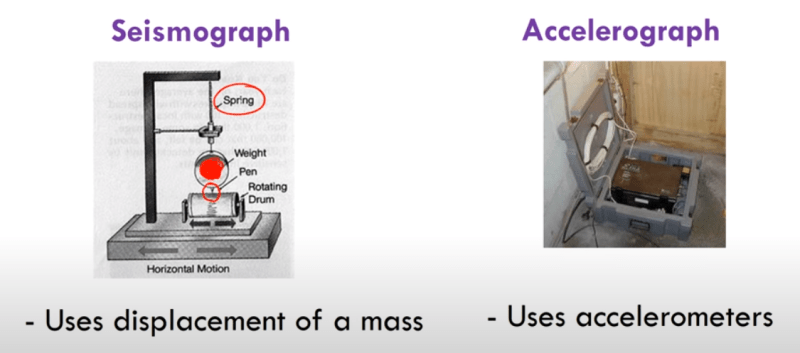

PS your data is likely from an accelerograph not a seismograph.

As far as the accelerograph v. seismograph, I'm not quite sure what the "difference" is here. There is a seismograph (my term I suppose) that we have blast vibration data from. The seismograph has a geophone with accelerometer if that is what you are referring to.

comment on seismograph / accelorgraph was an unimportant side comment. I watched a lecture recently that indicated that seismograh was the old school way of measuring EQs.
