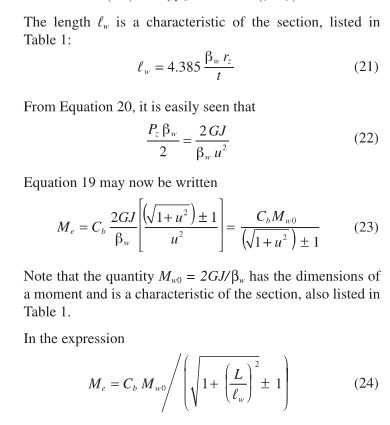

ASIC seems to treat angles in bending, refer to document:
"Specification for Structural Steel Buildings, edition 360-16, section F10".
When considering lateral torsional buckling, there is a factor "βw" section property, which is tabulated for American sections (TABLE C-F10.1).
Has anyone come across a generic expression which can be applied to other Unequal Angles or fabricated angles, in lieu of the integral derivation.
Or perhaps approximate numerical methods using Excel?

It has been a while since I had to look at this, but try the document Design Aspects of Single-Angle Members. It contains section properties Lw and Mw0 for various angles and those variables relate back to βw.
I think the document is available through AISC.
Equations are provided in Figure 11.7 of Guide to Stability Design Criteria for Metal Structures, sixth edition. It is Figure 11.5 in the fifth edition of the same text.
The reference from Hokie93 was quite helpful. After testing all angles in the original post, values were within 5%, perhaps as I did not take into account radii.
The only thing is that I had an opposite sign.
C1, C2, ßz and ßu (equivalent to ßw in AISC) were all negative. All other variables listed in the Figure below, I have as positive.
Can anyone advise why.
Thanks to Hokie93 and others for input.
Using the equations in the Guide, I ran the numbers for an L5x3-1/2x1/4 and L6x4x3/8 and got negative values for βw. In an absolute value sense, the computed βw values for the L5x3-1/2x1/4 and L6x4x3/8 cases are 2.46" and 3.15", respectively. These compare closely to the values published in Table C-F10.1 (2.40" and 3.14", respectively).
The βw values published in Table C-F10.1 are based on an average leg thickness for a given angle size. So the computed value for a specific angle size and leg thickness will vary slightly from the value in Table C-F10.1. If your computed values are within 5% of the Table C-F10.1 βw values (in an absolute value sense), I would say your math is correct.
The proper sign to be assigned to βw is discussed in Specification Section F10.2 and the Commentary to Section F10.2. I have found the sign discussion in the Specification to be more useful.
