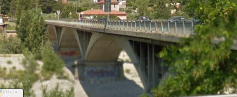

A curious design though.
Looks like an arch bridge, but the arches don't seem to meet in the middle.

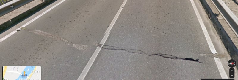

I wonder if this was the crack which doesn't look like an expansion section.
I went across the bridge on streetview and couldn't really see evidence of expansion joints.
LittleInch
I see several of those cracked out areas. They seem to be relatively evenly spaced and one at each end of the bridge. I would surmise that they are expansion joints that have been paved over. Also the concrete along the sides of the road seems to be heavily patched. As with the Morandi bridge this one seems to be pretty dilapidated. It would be interesting to see what lurks underneath.

Looks like the cantilevered walkways were a later addition which makes it difficult to see the arch. Would be interesting to know where this crack was.
The Google photo shows traffic queuing on one side sure to the junction layout on one side. That's never great for a bridge[pre][/pre]

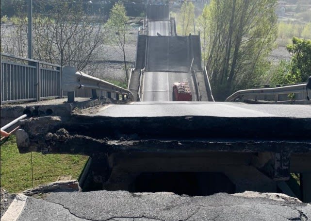

I'd say scour is a good candidate. You have an old bridge built with shallow piers, before the risk was recognized. There is a wide riverbed where high speed seasonal flow can concentrate around the piers and there are plenty of abrasives for the flow to carry.
In this photo you can see that multiple piers are broken off at the base. The break occurs between what looks like the base of the original piers and the top of a casting of retrofit concrete. I'd guess the casting was added after most of the damage was already done and the piles finally gave up.

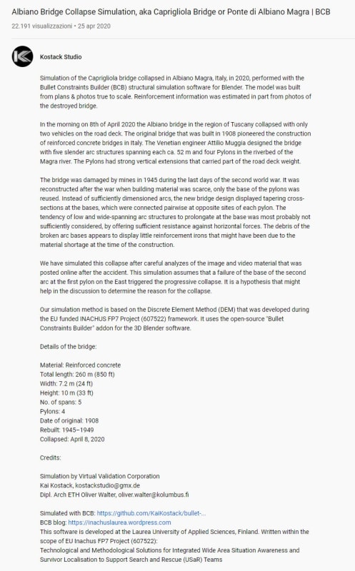

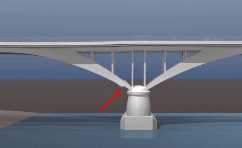

The simulation seems to imply the initial failure was a shearing failure through the bottom of the arch directly adjacent to the lower base piers.
Yes, I saw that as well. Did they say what input was used in the simulation program in terms of determining the point of initial failure? Was the simulation merely the animation of what was observed or was is the result of an actual analytical run predicting what the failure would look like?

The video description says that it is a simulation referencing online images and videos posted after the collapse, and that it assumes the failure location. Unfortunately, the images and videos used are not sourced.
I think it was done to match the result after the collapse. The first pier is the only one not to move, however it is also the only one which is piled.
