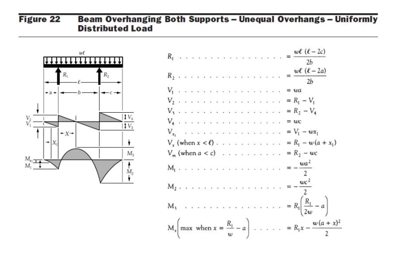

Hello everyone, I got a question.. may be a simple one for most of you.. what's the formula for the max applied moment on this Beam shown on the FBD below...? (it's cantilevered out over two pinned connections.. symmetrically)
Maximum moment occurs at where V = 0. In this case, you have to check 2 locations (at support and at mid-span between supports)
Calculate your reactions in terms of W and draw your shear and moment diagrams.
It should take about 2 seconds to solve for anyone who has completed Engineering Statics. If the center span was longer than the end spans, it might be necessary to draw the shear and moment diagrams, but with that span ratio, it's easier than that. I don't mean to be rude, but this site is for practicing engineers, not first year engineering students or those of other educational backgrounds.
@retired13 your post is misleadsing as this isnt the case for negative moments, ie a cantilever where max V & M occur simultaneously
Mcantilever = -wA2/2 = -32w
M at midspan of B = -32w + wB2/8 = -29.8w
The negative sign indicates tension on top and compression on the bottom. Without the cantilevers, the central span would have a small positive moment but as it is, the moment is negative across all three beams.

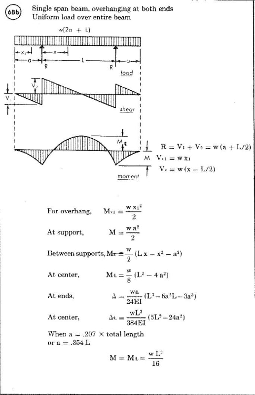

BA
blihpandgeorge,
Draw the shear diagram, see where V gets to zero along the axis (V raise above or drop below the axis).
In the cantilever, the shear is pushed up, and crosses, the axis by support reaction. But the shear will be again pushed down in the mid-span, so there are two location to check the moment for this symmetrical layout.
In a sense you are correct, my over simplified statement is misleading, as to suggest shear is zero at the cantilever, while it is a maximum. I shall have said "at where along the axis, the moment is a maxima/minima, when shear crosses the zero axis (change sign)."

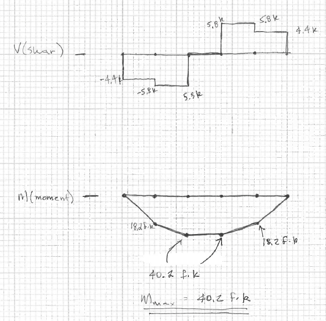

Thanks... I knew I could draw the shear and moment but I was wondering if anyone had/knew the formula for this condition to spare me the time.. my member is actually going to be point loaded as such so I went ahead and drew it out and figured it.. let me know If anyone sees an error I made..
man, your calcs show much more understanding then we gleaned from your post !
M = 4307*(49.5+45.5)/12+ 1307*45.5/12 = 39 kip.ft
with your round up, M = 4.4*(49.5+45.5)/12+1.4*45.5/12 = 40.14 kip.ft … confirming your calc
hey wait … is the outer bay 49.5 or 45.5 ?
oh, I see, you conservatively moved the load to the end of the beam

I (and others, apparently) took your loading arrows to be representing a uniform load. I apologize if I offended with my earlier post.
For point loads, you could use superposition, also - 4.4k * (3.8'+4.125') + 1.4k * 3.8' = 40.2k-ft.
Not much difference, 2s vs 20s, once you realize change in shear force. :)
