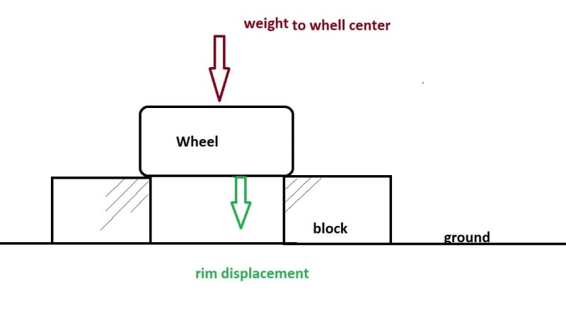

If really we take into account that all stiffness comes more or less together then i have simple idea
see scheme please
for clarification, i can use tire 10"/15" or 10,7/15" same diameter 21,5" but is different construction kevlar versus nylon
set 4 pieces around 1500 euro
i can put to 10"" or 11" rim both is in manufacturer range
Or maybe only simple put two different tires for any each axle,then test front or rear change............so real understeer will tell everything about this tires??

If you have both tire constructions, intermix front and rear, then reverse. Like eye doctor chart: "Better or worse?"
