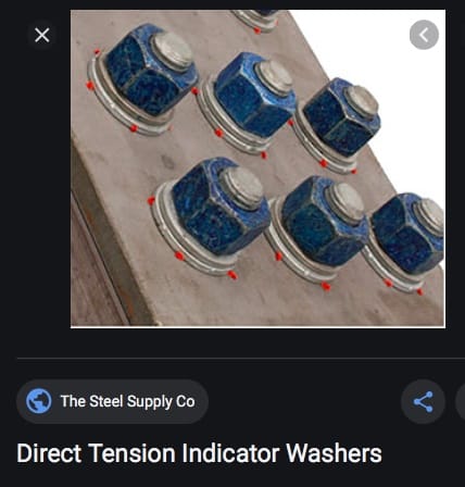

May add DTI washer to the bolting to facilitate the structure installation and inspection.

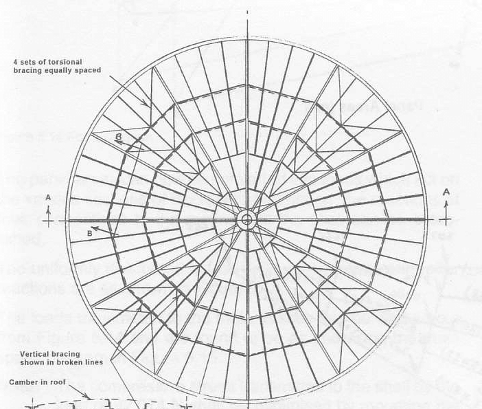

The bolts apparently snug tight as Geoff13 (Structural) stated. However there is another problem...the snip picture of the roof structure shows the main supporting members are trusses and these trusses supporting the rolled section rafters.
The vertical bracings are visible ..however , i could not see horizontal bracings...
The roof structure erected on scaffolding and shall be checked for horizontal bracing before dismantling the scaffolding.
The picture below depicts the typical roof bracing...
I've seen your problem myself. Inspectors want a torque, or a DTI, or a turn-of-nut, so they have something to inspect. With the standard snug-tight installation there's nothing to inspect, other than "Are the plies in firm contact?".
However if snug tight bolts are all that's needed for a design (and that's probably 99% of structural bolts) then all these other methods are just wasted manhours and dollars.
