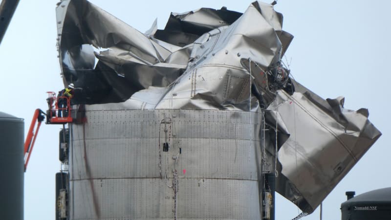

Doesn't look like buckling to me. More of a someone opened the wrong tap without opening another one first to equalise the pressure.
It looks like the failure has already started at the beginning of the video. The buckling seems to have started in the intertank area, but I can't find anything online that describes the tanks configuration of the vehicle so that's just speculation.

Thin shell buckling is notoriously difficult to predict. Very sensitive to initial imperfections. Hopefully they didn’t design it using eigenvalue buckling analysis. Lots of good info on shell buckling here: shellbuckling.com.
there is a huge fuel tank under those shells.. And it is the loadbearing structure. There is pics in the forum links.
I have seen a silo with a tank in it do this before because someone started pumping the contents out without injecting N2 in at the top to maintain positive deferential tank pressure to outside.
Looks more like a variety of vacuum collapse; if there were a cryofuel leak, it could supercool the atmosphere inside the cylinder, causing a pressure differential. Even a small pressure differential would be enough to buckle from the external air pressure.

A great example of thin-shell compressive buckling. The shell really tried to do an Euler buckling as shown by the initial diamond-like buckling mode shapes.

they did an initial test with water in both tanks and were testing in cold conditions using liquid Nitrogen
Starship does not have an inter-tank since lox and liquid methane are chilled there is a common bulkhead.
it failed is the lower tank which had lost pressure due to ground equipment (is the assumption)

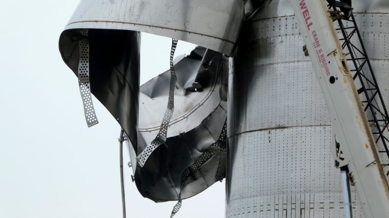

Since I haven't looked at the Starship in detail before, it would not make sense for me to pretend to know much about their design, but I'm really puzzled by something I see ("don't see) in the photos. Here's an example:
So while I can see strong evidence of numerous reinforcing members in the lower tank and possibly even a double-wall, the upper tank looks completely unreinforced. Those perforated straps would have some purpose, and I can see that there a a number of them in there, but with no evidence of inherent stiffness in the straps themselves, and few points of connection to the walls, I can't picture what they're there for. Also, the surfaces inside the upper tank wall are clean of any attached members. Not even a ring stiffener!
Say what you want about this structure withstanding 1G standing vertically in gravity, my question is how this was expected to tolerate >5g under rocket thrust.
