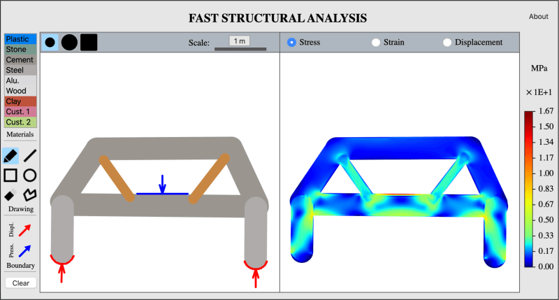

I have started to develop a structural analysis tool (linear elastic response) using an alternative method to FEA, and I am wondering if the tool would be useful. The method uses a regular grid rather than a mesh. So it is less accurate for sharp shapes but seems to be very fast. Since I am not a structural engineer, I wanted to get thoughts on this to see if this kind of tool (coming from microstructure studies) could be helpful for the design process? For example, at a very early stage of a design, drawings could be done in a few seconds. Here is the tool I am working on: fsa.plvaldenaire.com

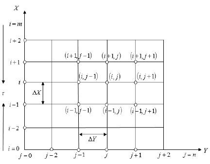

It involves the same equations as the ones used by FEA (mechanical equilibrium and linear elasticity from continuous mechanics). The difference is from the numerical integration. Here, it uses Finite Difference rather than Finite Element/Volume so the fields (stress and strain tensors) are discretised on a regular grid. That leads to one drawback: shapes are 'aliased' but also one advantage: very fast and less memory usage. The quality of the result depends directly on the resolution of the grid. At high resolution it should give the same exact solution as FEA.

Discrete derivatives with FDM lead to a grid with nodes periodically spaced (see picture). A grid may not be as good at describing shapes as a mesh, but a grid has some advantages. For example, using Fourier Transform to solve equations in Fourier space, which is very fast (you don’t inverse a huge matrix, but simply multiply matrices).

You can draw any shape. It is only limited by the resolution. I have attached a screenshot showing shapes with curves.
