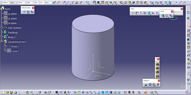

Catia vba edge fillet
NaWin55
Mar 21, 2020
98
IN
hello all.
I want to create edge fillet to this pad, i recorded the macro for fillet but i am not getting what this line is
here is the line for fillet reference
part1.CreateReferenceFromBRepName("REdge:(Edge:(Face:(Brp:(Pad.1;2);None:();Cf11:());Face:(Brp:(Pad.1;0:(Brp:(GSMCircle.1)));None:();Cf11:());None:(Limits1:();Limits2:());Cf11:());WithTemporaryBody;WithoutBuildError;WithSelectingFeatureSupport;MFBRepVersion_CXR15)", pad1)
i want to know how to select specific edges and faces to create fillet or draft in part design for pad type objects
i tried with SelectElement2,3 but did not work
i Don't know how to use filters also in VBA scripting
here is the image, i want create edge fillet on to top and bottom edges
Hi NaWin55.
I can't explain in detail because I don't understand English.
I created a sample macro.
After executing the macro, select the body.
Create fillets on all round edges.
It's not a macro that works for anything, but it should work for simple cylinders.
Code:
'vba
Option Explicit
Sub CATMain()
    ' Select Body
    Dim msg As String
    msg = "select body"
    Dim targetBody As body
    Set targetBody = SelectItem(msg, Array("Body"))
    If targetBody Is Nothing Then Exit Sub
    ' Get Circle Edge Reference List
    Dim circleEdgeRefs As Collection
    Set circleEdgeRefs = getEdgeReference(targetBody)
    ' Execute Fillet
    Dim filletSize As Double
    filletSize = 5#
    Call createFillet(targetBody, circleEdgeRefs, filletSize)
    ' Finish
    MsgBox "Done"
End Sub
Private Sub createFillet( _
    ByVal bdy As body, _
    ByVal refs As Collection, _
    ByVal size As Double)
    Dim pt As part
    Set pt = GetParent_Of_T(bdy, "Part")
    Dim fact As ShapeFactory
    Set fact = pt.ShapeFactory
    Dim prop As Long
    prop = catTangencyFilletEdgePropagation
    Dim flt As ConstRadEdgeFillet
    Dim ref As Reference
    Set ref = refs.Item(1)
    Set flt = fact.AddNewSolidEdgeFilletWithConstantRadius( _
            ref, prop, size)
    If refs.Count < 2 Then
        GoTo finish
    End If
    Dim i As Long
    For i = 2 To refs.Count
        Set ref = refs.Item(i)
        flt.AddObjectToFillet ref
    Next
finish:
    pt.UpdateObject flt
End Sub
Private Function getEdgeReference( _
    ByVal bdy As body) As Collection
    Dim lst As Collection
    Set lst = New Collection
    Dim shp As shape
    Set shp = bdy.Shapes.Item(bdy.Shapes.Count)
    Dim sel As selection
    Set sel = CATIA.ActiveDocument.selection
    CATIA.HSOSynchronized = False
    sel.Clear
    sel.Add bdy
    sel.Search "Topology.CGMEdge,sel"
    If sel.Count2 < 1 Then
        GoTo finish
    End If
    Dim pt As part
    Set pt = GetParent_Of_T(bdy, "Part")
    pt.InWorkObject = shp
    Dim fact As HybridShapeFactory
    Set fact = pt.HybridShapeFactory
    Dim ref As Reference
    Dim bRepName As String
    Dim i As Long
    For i = 1 To sel.Count2
        bRepName = getBrepName(sel.Item2(i).Value.Name)
        Set ref = pt.CreateReferenceFromBRepName(bRepName, shp)
        If fact.GetGeometricalFeatureType(ref) = 4 Then
            lst.Add ref
        End If
    Next
    sel.Clear
    CATIA.HSOSynchronized = True
finish:
    Set getEdgeReference = lst
End Function
Private Function GetParent_Of_T( _
    ByVal aoj As AnyObject, _
    ByVal T As String) _
    As AnyObject
    Dim aojName As String
    Dim parentName As String
    On Error Resume Next
        aojName = aoj.Name
        parentName = aoj.Parent.Name
    On Error GoTo 0
    If typename(aoj) = typename(aoj.Parent) And _
       aojName = parentName Then
        Set GetParent_Of_T = Nothing
        Exit Function
    End If
    If typename(aoj) = T Then
        Set GetParent_Of_T = aoj
    Else
        Set GetParent_Of_T = GetParent_Of_T(aoj.Parent, T)
    End If
End Function
Private Function getBrepName( _
    selectName As String) As String
    Dim tmp As String
    tmp = Replace(selectName, "Selection_", "")
    tmp = Left(tmp, InStrRev(tmp, "));"))
    tmp = tmp & ");WithPermanentBody;WithoutBuildError;WithSelectingFeatureSupport;MFBRepVersion_CXR15)"
    getBrepName = tmp
End Function
Private Function SelectItem( _
    ByVal msg$, _
    ByVal filter As Variant) _
    As AnyObject
    Dim sel As Variant
    Set sel = CATIA.ActiveDocument.selection
    sel.Clear
    Select Case sel.SelectElement2(filter, msg, False)
        Case "Cancel", "Undo", "Redo"
            Exit Function
    End Select
    Set SelectItem = sel.Item(1).Value
    sel.Clear
End Function
