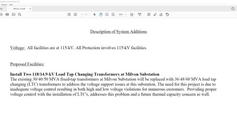

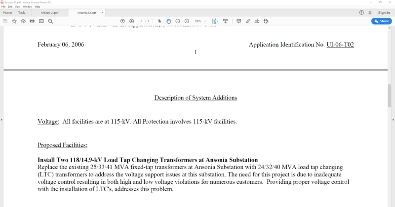

And in some cases (United Illuminating in Connecticut as one example) was able to get away without any voltage regulation for decades when the transmission system was lightly loaded and local generation was ample. In fact the West Haven Substation still doesn't have LTCs or any voltage regulation as I understand it (except a 115kv cap bank, if that counts :P).

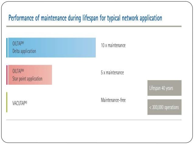

The good news today is that there are promising options commercially available with a new vacuum OLTC design in the market that show promising expectancy to improve the transformer reliability.
