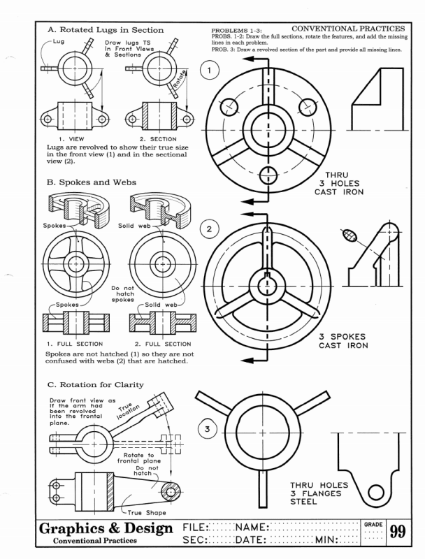

Actually I'm looking to do the opposite of ommiting ribs for clarity. We have probably hundreds of legacy drawings with ribs done to the preferred convention shown in the pic:
The rib is shown in the section but not hatched, and rotated to show fully in the section view instead of foreshortened. Previously, I've hidden lines and sketched new lines and hatch boundaries in but this sort of hybrid drafting sucks and results in a drawing that you can't point at the next part in the series and have the drawing done except for changing some notes and numbers. Except for the lack of a 3D product, a 2d drawing of a column with a break in it is great, because you just add what you need to the overall length dimension and save as the next drawing in the series.

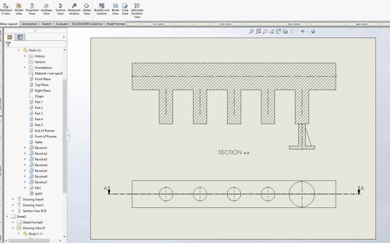

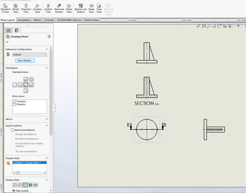

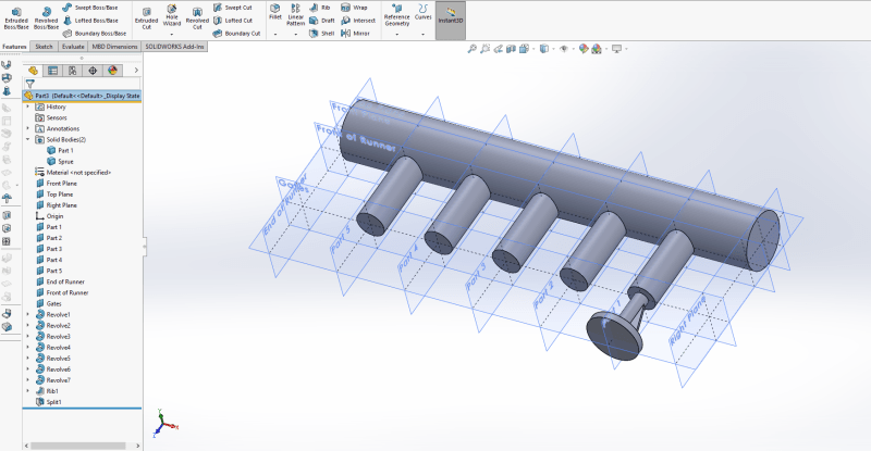

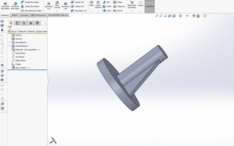

So you start with a part file for the casting and then use the split feature to seperate that part file into multiple bodies, which you then save out as distinct part files, correct? In these part files you have one feature in the feature tree; your "stock" feature, which makes your part a derived part and maintains the link, correct? Therefore, when creating a section view in the drawing for this derived part, there is no rib feature to select to exclude from your section view?
Assuming I have got that right, what I would do instead is use the split feature as before, but dont bother saving out the result as distinct part files. Instead do everything from the (now multi-body) master part. When creating a view in your drawing file you can select the bodies that you want to be included in the view, so you can use this to create drawings of the individual "parts". This method keeps the feature tree in-tact in the drawing file, allowing you to select the rib feature to exlude from a section view. It also just seems more robust to me, as you only have one part file and one drawing file to manage (you could have multiple drawing files but I would question the need).
